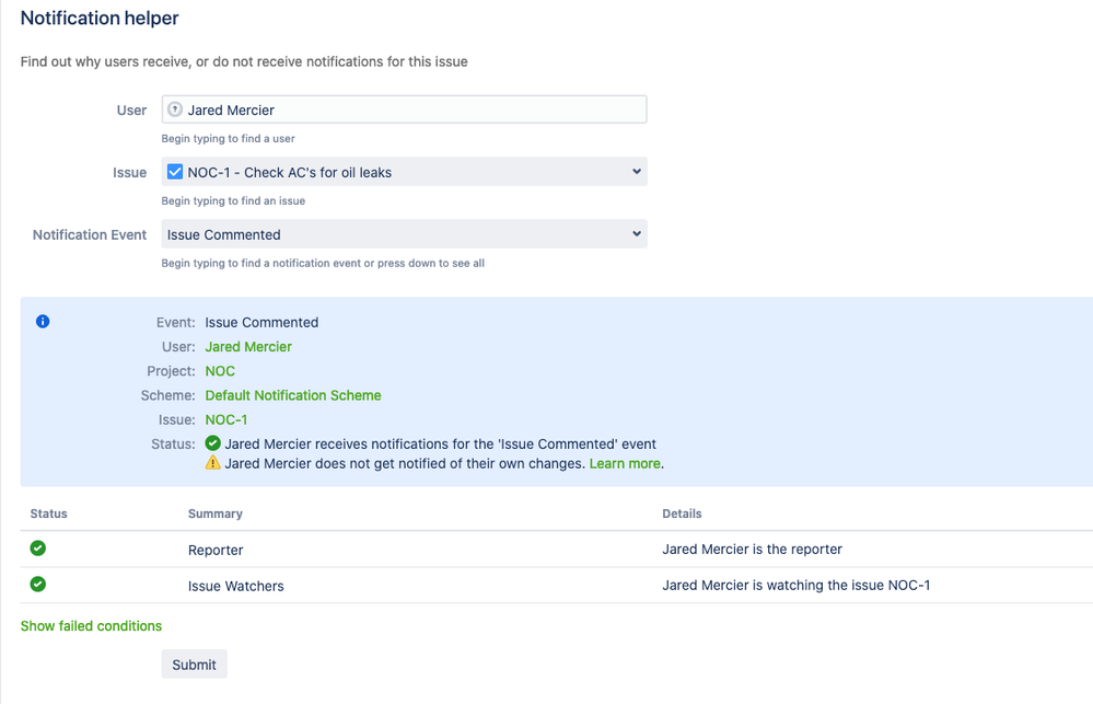

We're just using default notification scheme and the notification helper confirms we should receive the emails. Not sure what we might be missing.screenshot.png

Did you confirm that outgoing email is enabled on the server?   Even if the email server is disabled the notification helper will say everything is fine.  Please check the server by going to System>Outgoing Email
