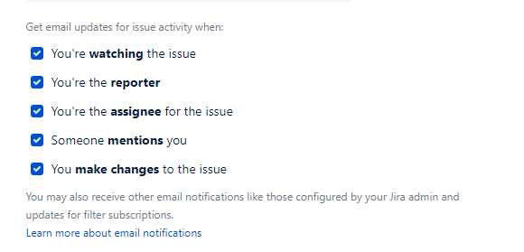

Searching again for blocks and bounces, I found some bounces due to the following error:
550: 550 [internal] [oob] The recipient is invalid.
I removed the bounces from all email addresses. Please, check if you receive notifications now.
If not, please confirm what I said above about watching the ticket and not being a reporter and assignee. Also, double-check your profile.
