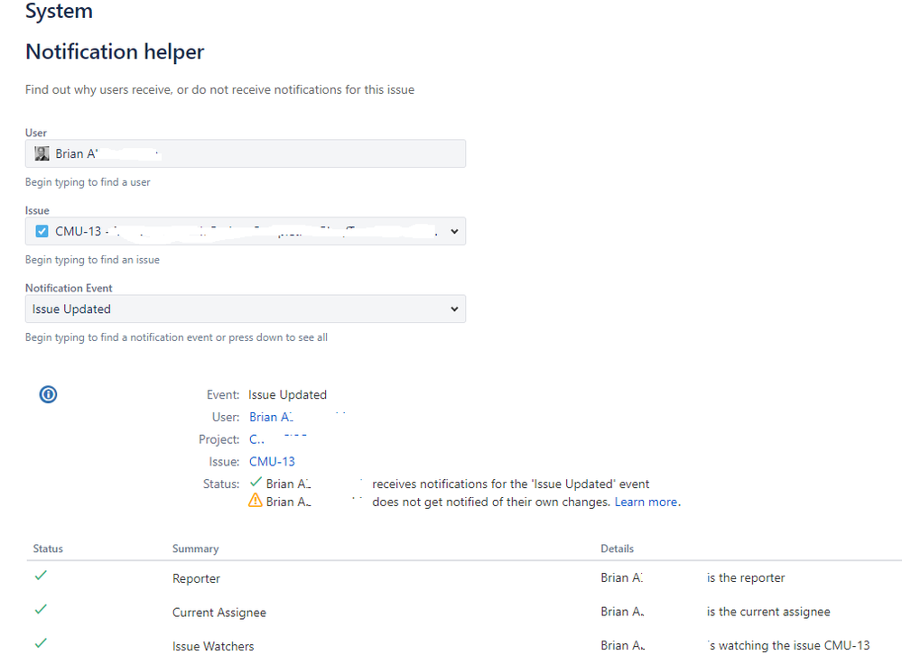

Thanks Trudy ... @ mentions don't work for me either. I'm in a Team Managed project. I haven't tried the Notification Helper, I'll give it a shot and follow-up.
Ok, I don't seem to get emails triggered by Notification Helper.
Notification Helper does not send you emails. Notification Helper tells you if Jira thinks you should get an email when a specific event happens on a specific issue.
Can you show us the output of the Notification Helper screen?
Thank you.
From that I can see that you should be notified if there is an Issue Updated event for that issue, as long as you are not the person who made the update.
If others are making changes that fire the Issue Updated event (like changing the content of the Summary or Description fields or other fields) and you are not receiving the emails, and you don't receive emails when you are @ mentioned, and you have confirmed that the emails are not going to your spam folder or being blocked by your email provider, then the most likely cause is that your email address got blacklisted on the Atlassian side.
