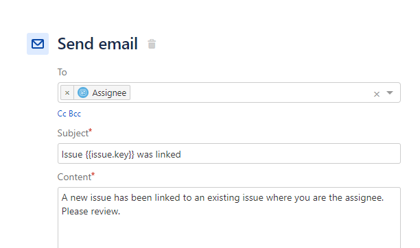

Is there a way within automations that I can have an email sent to the assignee of an issue when a new issues is created/linked to it?  Suppose I have Issue A created and Dev in progress and a user links a Issue C to it, I want to send an email to the Assignee on Issue A so they are aware of the new linkage.  I have it partially working but it is sending an email to the Assignee on Issue C and I need the email to go to the Assignee on Issue A.
We also have scriptrunner if that is an option.

Thanks Trudy!  I appreciate you brainstorming with me on this.  I would have also thought the same, but I missing how to configure.  Have you been successful at configuring?
The "To" line you cannot(not that I see) indicate of which issue for.  You can pick a value of "Assignee" but I don't find where/how to pick for Issue A.  In my example, the email continues to go to the assignee on Issue C.  Typically upon create we don't set the assignee, therefore the automation is basically failing as assignee value is blank.  Nonetheless, I want the email to go to the assignee on Issue A.

Odd - but it seems to be working now, with out any changes. :-) I'll keep monitoring and see if we continue to face any errors.
And we did get more "errors".  So it seems the email will send, depending on which issue the linking is initiated on.
  • When I create a brand new issue(Issue C) and set the link during the issue creation, the email is going to the assignee on Issue A(yay).
  • If both issues have already been created and I link from within Issue C to Issue A, email fails to send as we don't have assignee on Issue C
  • If both issues have already been created and I link from within Issue A to Issue C, email sends to assignee on Issue A(yay).
I still don't think this will work for us as we ALWAYS want the email sent to assignee on Issue A, regardless which order of steps were taken or link was initiated on.
