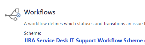

I assume you are a jira admin.
first go to the project then click on the cogwheel, and check the summary.
then you will see what issue type is connected to which workflow.
