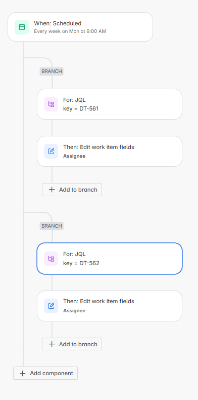

@Amanda TAY,
I thought you were talking about dozens of work items. But if you can do it like in your own answer:
Ok, i found the answer, copy more branches for each task. There's probably more elegant ways of doing this, but this is good enough for now.
you can simply create a query like this:
Key in (DT-561, DT-562, ...)
That would make your rule quite a lot easier.

Amanda TAY
June 18, 2025

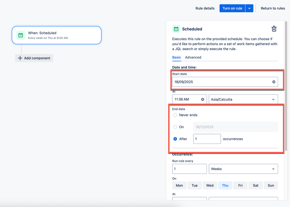

Hey @Amanda TAY
You can use scheduled trigger in automation to fulfil this requirement.
In the scheduled trigger, set the Start date to the future date when you want to run the rule.
The end date can be set as "After 1 occurence", so the rule will run only once:
Editing the issue(s) is quite straightforward. Simply include the JQL for the required issues in your schedule trigger, and add an edit action item in the next step.
I hope this helps!
Thanks
