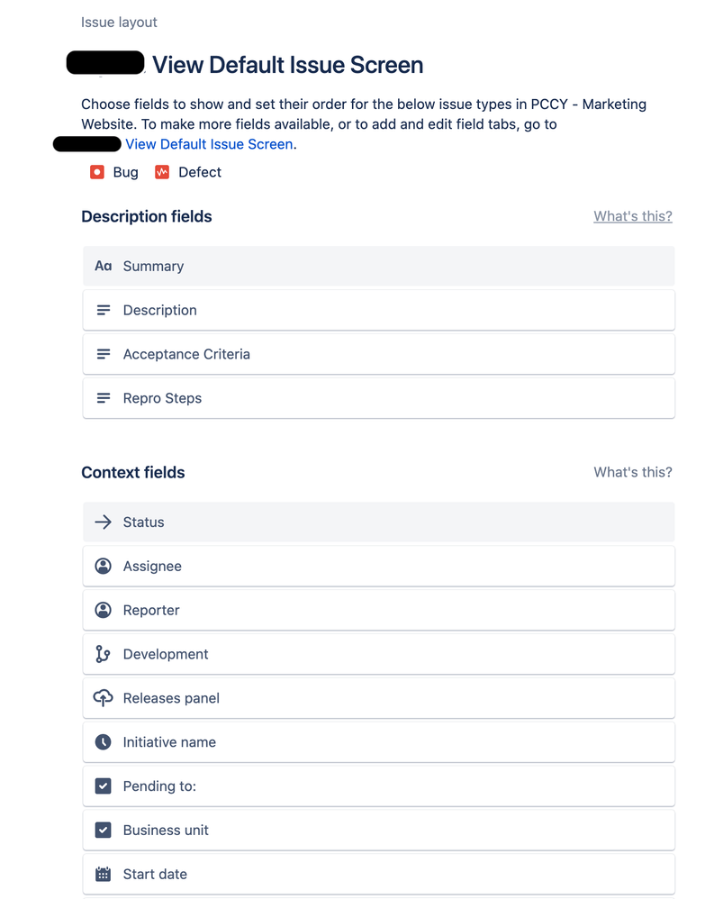

Hi,
is there a way to edit issue layout for all projects and not just for the specific project?

Hi Yaniv (and Gail):
Using the Issue Layout functionality you have in your screenshot above is specifically implemented so that it can be changed for one project only. Even though the same screen scheme is used by multiple projects.
To change the screen for all projects that use that scheme, you have to change the screen inside the scheme itself - not with the Issue Layout.

so just to make it clear for me... this means we cannot change the issue layout (not the screen but the layout it displayed on the "view") for multiple projects but only for one project each time
correct?
John Funk
June 9, 2020
Correct! The only thing you can do for all projects is change the order of the fields

I checked out the Scheme Screen for one project. and the fields' order is ok.
When I have Created a new issue there - the fields' order is still the same as the scheme.
But, in Edit / View issue state - the order is different.
I assume that in Layout setting for that project the case will be resolved. But which efficient solution is suggested for a multiple projects with this Screen Scheme ?

@Shira Izon  - Right now there is not a way to share the Issue Layout across multiple projects. But here is a feature request to do that which you can vote for and follow:
https://jira.atlassian.com/browse/JRACLOUD-71630

Hi @Yaniv Kalif -
If you are saying you want to edit screens of multiple projects, then you need to have project admin permissions for those projects.
If you are saying you have all the permissions, and your requirement is that when you change layout of one project, then simultaneously it changes the layout of other projects too, then you need to have SAME screen names for all those projects. Simply, create one common screen scheme for all projects.
Eg, if project A uses screen scheme XYZ, then projects B, C, D,etc should also have same screen scheme XYZ for their issue types.
Let me know if that helps.

I do have admin permissions and im trying to edit projects who uses the same scheme and same screen but only the specific project is changed.
I'm referring to the new issue view. it looks like you can edit only this specific project
