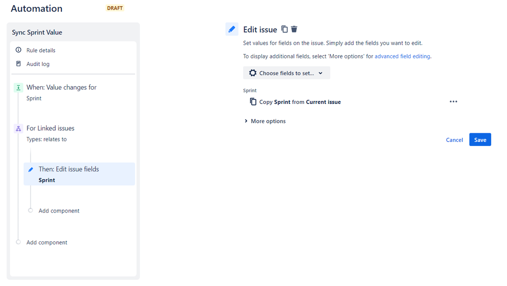

Hi @[deleted]
Please try below Automation rule setup:
Hope this help you!
