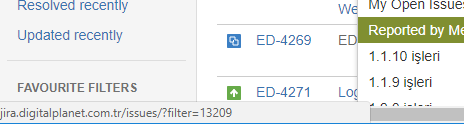

Hi @Nir Haimov i just used the script to replace my "reported by me" filter
For this issue. I created a new filter and get the id of it. And put into the script
Then i changed replace code for filter id "-2"
Then i added the script to admin panel > system > user interface >Announcement Banner
This changed both. Top menu and the left menu
Left menu
Top menu

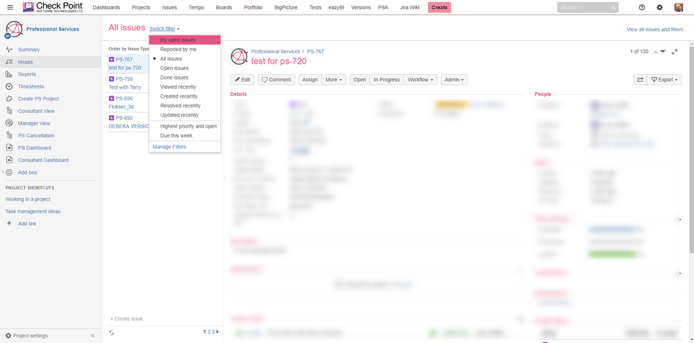

Hi @Ozan Bayram
I wanted to change the default filter inside the "issues" menu inside the project (see attached)
Couldn't find a way to do it... any suggestions?
When i clicked that link it navigates to a link like this "?filter=myopenissues"
Maybe you could give a try to replace that one
but i dont think this is possible
Yeah,
It's not possible, though you came up with a way to accomplish that
Thanks any way :)

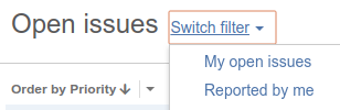

@Damian Nowak3@Ozan Bayramis there a way to extend this workaround to the Switch filter dropdown menu?
don't know but maybe same solution can be applied. Basically you need to find what do you want replace and change the script
Thank you Ozan.
Actually I don't know where to search for the tags I need. Is there any documentation or something like that to search for them?
