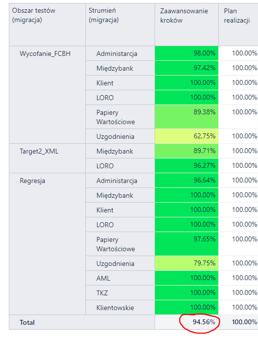

I've got two tables from two reports for the sake of simplicity, let's take the numbers 501 and 305.
Report 501 is about scope of test and got column:
Zawansowanie kroków = Advancement of the test step,
which contains measure:
CASE
WHEN CurrentTuple(VisibleRowsSet()).Item(0).Name = '$total_aggregate'
THEN
Avg(VisibleRowsSet(),
([Measures].[Count of test step succes] + [Measures].[Count of test step cancel]) / ([Measures].[Count of test step])
ELSE
END

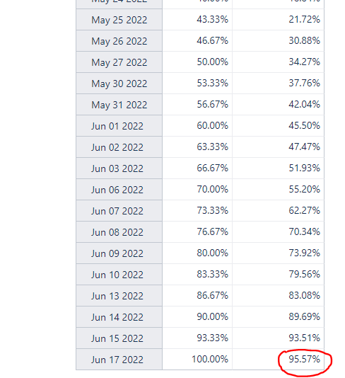

Report 305 is about daily progress and got column:
Zaawanoswanie testów = Advancement of the tests,
IIf(
DateDiffDays(
DateWithoutTime([Time].CurrentHierarchyMember.StartDate),
DateWithoutTime(Now())
) >= 0,
[Measures].[Advancement of the tests (all)], NULL)
I expected the result of calculation will be the same figure. So the total of the column form report 501 will be the same as the row from current day from report 305, but it isn't.
Is this problem with calculation in measures or with import from database?
If you have question about any details feel free to ask.
