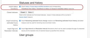

Step 1:
Make sure you're importing Statuses and history

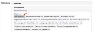

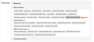

Step 2:
Add measures to your column box and select 'Days in Transition Status' and 'Open Issues' assuming you only want to look at open issues

transition import.jpgSnip 2017-06-12 09.51.26.pngSnip 2017-06-12 09.51.41.png

Liliya Sapogovskaya June 12, 2017
Hi Collin,
Thank you for your response, but your solution doesn't work for me.
"Days in Transition Status" shows how many days each issue has stayed in status. I want to get logged time between two transitions.
It could be great if I can get a transition date, so it will be possible to compare dates, but it looks like EazyBI doesn't provide this information.

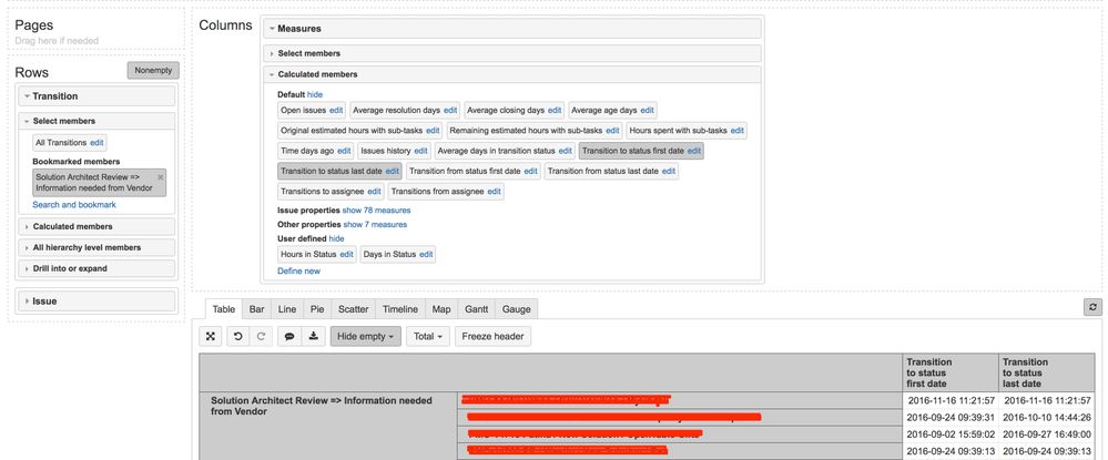

CollinM
June 12, 2017
I see what you're saying.  Maybe these fields would work.  I've crossed out issue names as I don't have fake data to try this with.
Unfortunately no,
With this dates it's not clear when the task was moved from testing to development and from development to testing.
Just a small example: QA engineer moved the task from Testing to Development on the 5th of June.
Developer has logged some time (5 hours) for the task and moved it to Testing at 7th of June.
Eventually I want to get this 5 hours (not 2 days or anything else).
I thought if I know the dates of this events, I can analyze how much time developer logged for each task.
Sorry that the original question wasn't correctly described.
