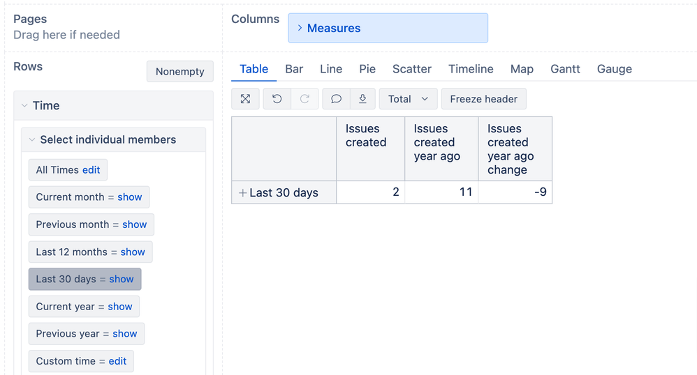

You can use eazyBI's standard "Time ago" calculations to compare measures between the current and previous year.
Here's a simple example from my instance to give you an idea:
Best,
Marita from eazyBI support

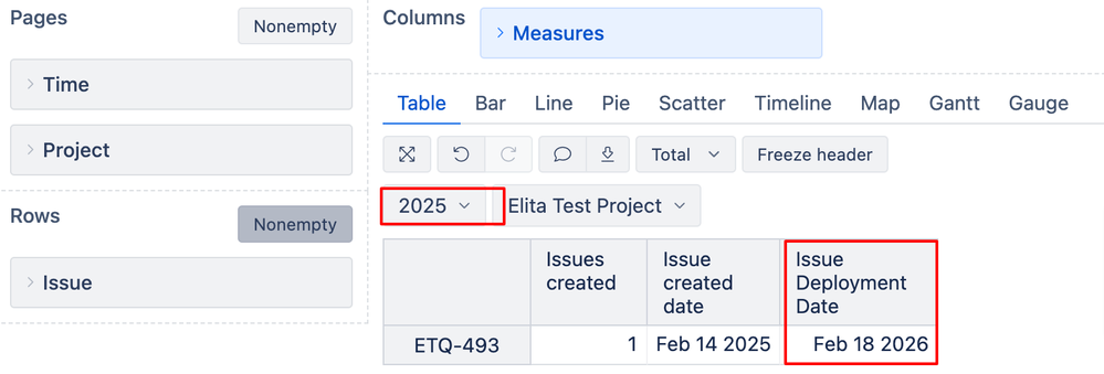

You can use the measure "Issues with deployment date" to create your MDX formula.
There are two different approaches depending on how you want to handle issues with a Created Date and Deployment Date in different years, as in the example below.
Scenario 1: count the issue for 2025 even if the deployment date is in 2026
(counted by created date in 2025)
This formula will count an issue by the creation date even if the deployment date falls in a different year. For example, if an issue was created in 2025 but has deployment date in 2026, it will be counted in 2025.
Sum(
  Filter(
    Descendants([Issue].CurrentMember,[Issue].[Issue]),
    not IsEmpty([Measures].[Issue deployment date])
  CASE
  WHEN
  [Measures].[Issues with deployment date] > 0 THEN
  ELSE
  [Measures].[Issues created]
  END
Make sure to change Formatting to "Numeric" for this formula.
Scenario 2: count the issue for 2025 only if the deployment date is in the same year.
This formula will only count an issue in the year of its deployment date. Using the same example - issue created in 2025 with deployment date in 2026 will only be counted in 2026.
Sum(
  Filter(
  CASE
  WHEN
  THEN
  1
  WHEN
  [Measures].[Issues with deployment date] > 0 AND
  [Measures].[Issues created] >0
  THEN
  1
  END
You can choose either formula depending on what results you are looking & you can apply "Time ago" function for the measure.

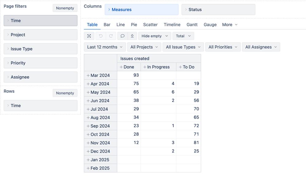

Predefined measure [Open issues] shows a number of all unresolved issues at the end of the corresponding Time dimension period (regardless of when they were created). Also, [Issues resolved] shows a number of all resolved issues in the time period (regardless of when they were created).
To see the number of issues created and resolved in the same time period, create a new report-specific calculated measure [Resolved same period] with the following formula:
CoalesceEmpty(Sum(
Filter(
-- iterate through set of issues
Descendants([Issue].CurrentHierarchyMember,[Issue].[Issue]),
-- apply filter criteria to each issue
DateInPeriod(
[Measures].[Issue created date],
[Time].CurrentHierarchyMember ) AND
DateInPeriod(
[Measures].[Issue resolution date],
-- numeric expression - sum of relevant issues
),0)
Then, you can create one more calculation to see the number of issues that were not resolved in the same period as they were created (I suggest not using the name “Open issues” because it will be confused with a predefined measure):
[Measures].[Issues created] - [Measures].[Resolved same period]
Hope this helps
