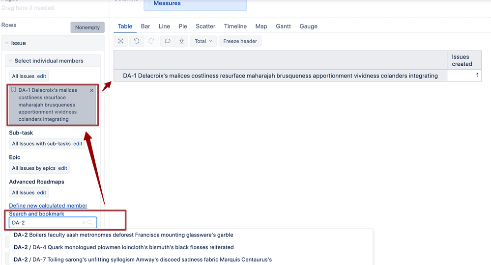

I am Ilze from eazyBI support.
If you want to display tasks in the report row, select Issue dimension in the report rows, and use Search and bookmark option to find the needed task, and then select it for the report:

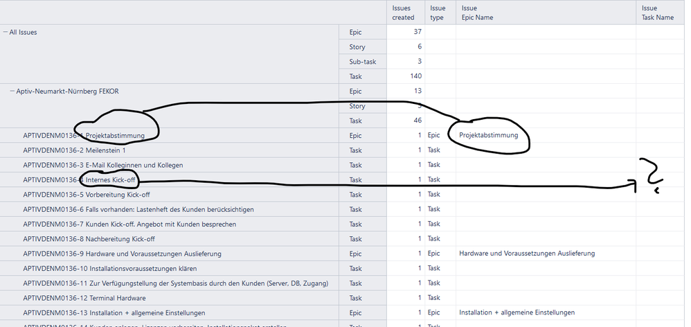

Thanks for answering. In the picture below you can see my issue. How could it work? I´m don´t have knowledge in mdx thats why I can not solve it. Epic Name is displayed incolumn. How to do with Task?Screenshot 2023-03-16 105922.png

Hi,
Thank you for the screenshot!
You may want to import the issue summary as a property (e.g. Issue Summary), and then you can display it in the report as a column for any issue type.
There is a thread where is described how to get the summary imported as a property, using JavaScript calculated custom field: https://community.eazybi.com/t/get-summary-value/4028/2

@Ilze Leite-Apine - eazyBIIt has worked. Thanks!
