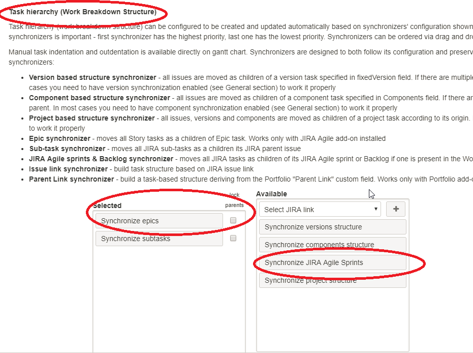

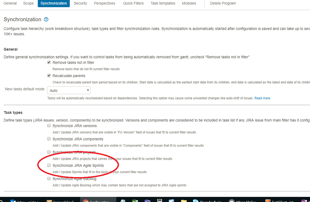

Under program configuration, Task Types: leave Epics unchecked.
Under program configuration, Task hierarchy: move 'Synchronize Epics' to the Selected box.  Do NOT move the 'Synchronize JIRA Agile Sprints'WBS.pngTasks.png
