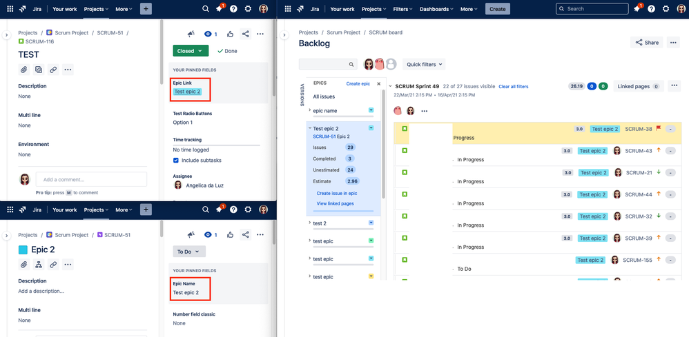

Hello @Simon Metz,
Testing on my local site, I wasn’t able to replicate the same issue. I changed the Epic name and after I refreshed the backlog and the ticket linked to the Epic, it changed.
On Classic projects, there is the option to add Epic summary and Epic name.
The Epic name is the one that will appear in the field “Epic link” on child issues and also on the backlog.
Can you please confirm if the field “Epic name” was updated?
If so, can you go to another ticket and search for that Epic? Does it show the correct name?

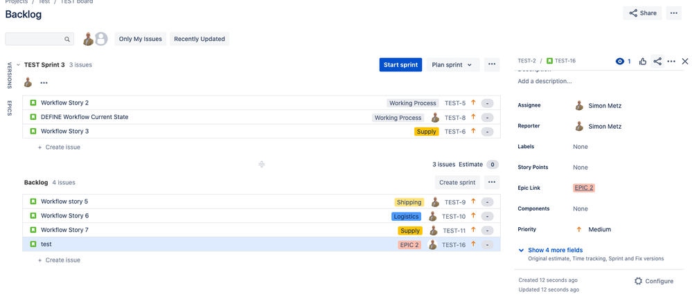

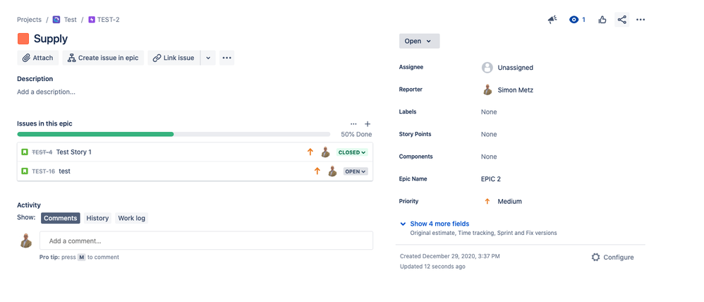

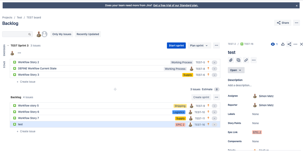

Here are some screenshots. I had a EPIC renamed as "Supply" but it still shows up in EPIC list as EPIC 2 , yet when I go into the EPIC 2 detail it correctly displays as Supply. so to answer your question, Yes Epic 2 was updated/renamed but it doesn'tScreen Shot 2021-04-06 at 1.32.01 PM.pngScreen Shot 2021-04-06 at 1.32.12 PM.png seem to have propagated up the tree.
Please let me know your thoughts, if I am doing something wrong. I did see a number of other posts when the "New" view was installed that this was an issue.

I note on your screen image of TEST-2, that:
  • the summary field at the top of the view is "Supply"
  • the epic name field at the right of the view is "EPIC 2"
What happens when you edit the epic name field?

Bill. I did edit the EPIOC name from EPIC 2 to Supply. My issue is that the original name still shows up in backlog with the original name of EPIC 2. This was noted back in 2019 when the "New" view was pushed out that editing EPIC names didn't displed on the backlog.
The details of issue "Supply" are arrived at by clicking on "EPIC 2" in the right panel from the story "Test 2" I know this doesn't make sense, but it is happening here.

Thanks, Simon.  Like @Angélica Luz I wasn't able to reproduce your results with a Company-Managed project (Classic).
Based upon what you describe and your backlog image, it appears to be showing two stories (TEST-11 and TEST-16), both pointing to the same epic (TEST-2) and yet showing two different epic names.

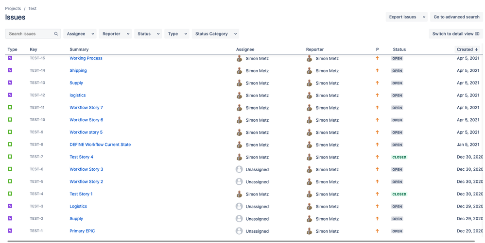

How about this to confirm: please run this filter on Advanced Issue Search:
issueType = epic ORDER BY Summary
Then on the right side of the view under Columns, add the Epic Name.
The results will show you if you have any epics with the same Summary and different Epic Names.  In that case, perhaps you are seeing two different epics.

On the backlog, those labels with the Epic name are based on the field “Epic name” and not the Summary.
As Bill mentioned:
The Epic TEST-2 has the Epic name “EPIC 2” and the child issue TEST-16 that is appearing on the backlog shows “EPIC 2”, which is correct because it’s the name of the Epic TEST-2.

How can I edit the name of any EPIC so that it reflects back into a Story link and in the backlog. You are all correct that I created a new EPIC titled Supply, because I was unable (I'm not the only person with this issue) to edit the name of an existing EPIC.
Please provide step by step instructions on how to edit the EPIC name, starting at the Backlog screen.
When I go to my list of Issues there is no EPIC titled EPIC 2, yet EPIC 2 still shows up on the backlog as aligning to a story. This simply doesn't make sense and is a poor user experience.

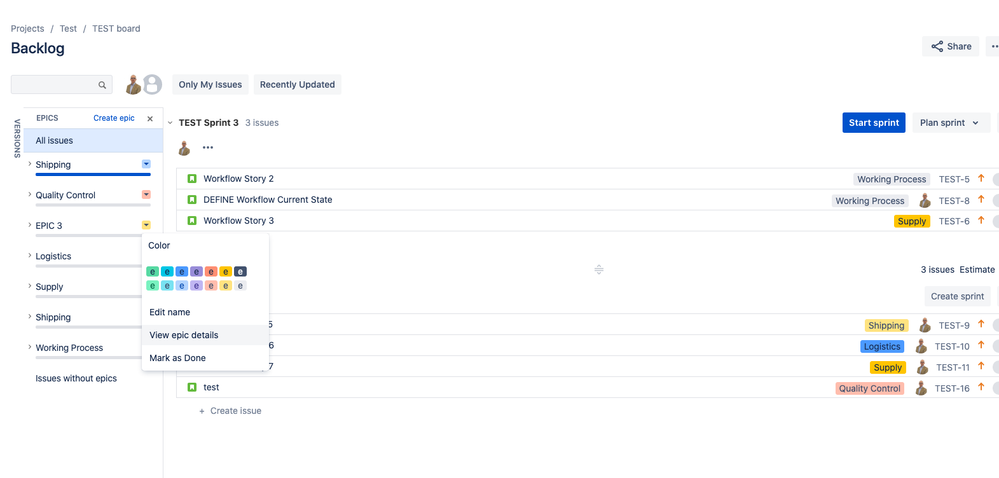

To edit the Epic Name from the Backlog view:
  1. Select the epic pane on the left so it is visible
  2. Select the epic you wish to update
  3. On the right side of the epic, select the drop-down arrow and View epic details, which opens the epic in a browser tab
  4. Locate the epic name field on the right side of the view.  If you do not see it, select Show more fields at the bottom of the view.
  5. Edit the epic name field
  6. Select the checkmark to save your changes

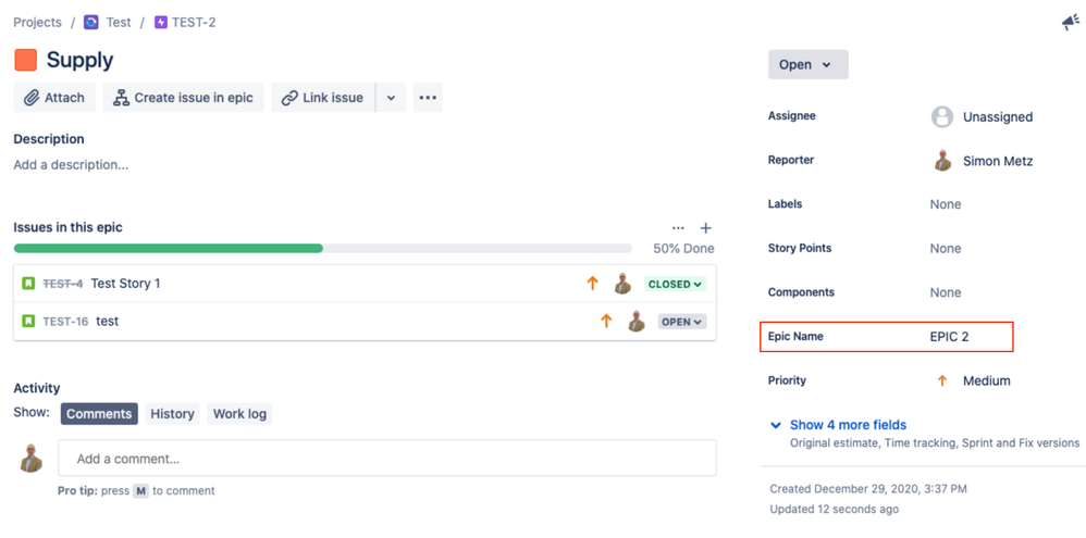

To be clear though when I go to EPICs and click on "EPIC Detail", make an edit and click the checkmark as you mentioned, this shows a label (not sure if this is really a title) that I previously attempted.
As a very experienced program manager and software developer, this is not initiative at all. If I change a label and check okay it should be displayed everywhere with that changed.
This is way too complicated if there are two ways to edit a title, one works and another doesn't. The method you describe is not easily accessed based on how many other JIRA users have had the same issues over the years. :-)Screen Shot 2021-04-07 at 10.20.33 AM.pngScreen Shot 2021-04-07 at 10.20.54 AM.png

But if you had this problem like I did, just got to the backlog, open the epic list:
  3. On the right side of the epic, select the drop-down arrow and Edit name, which gives you the option to update the name. (Changing the name on the epic for some reason does not update this label).
  4. Once the name is updated just press enter
  5. Check all tickets linked to that epic and they should display the right name now.
