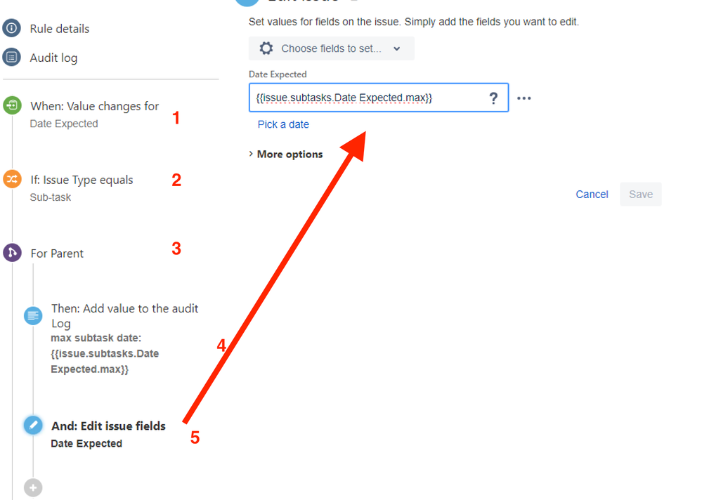

Trudy P Claspill
July 6, 2024
@jira_admin_cu
1. Trigger: Field Changed: specify your date field
2. Condition: confirm the change occurred in a Sub-task
3. For Related Issue: Parent -- changes the focus of the rule to the sub-task's parent issue.
4. Log action: this will print the value that you will next be updating into the parent issue.
5. Edit Issue - this edits the parent issue.
The smart value used in 4 and 5 is {{issue.subtasks.<your date field>.max}}
That smart value will get the maximum value in the specified field from all the subtasks.
jira_admin_cu
July 9, 2024
Thank you @Trudy P Claspill . Its working as expected.
