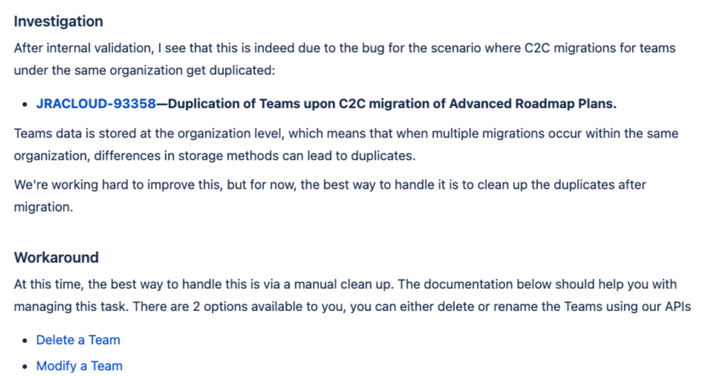

After reporting it to Atlassian we've received following message:
Due to the fact that some of the Teams were not only duplicated but occurred 6-10 times, before we've noticed the issue, users were adding the Team's value to the tickets that caused the situation were Team A is added to around 4k tickets but from the Team ID perspective they are added to diferent teams cause Team A is replicated 8 times.

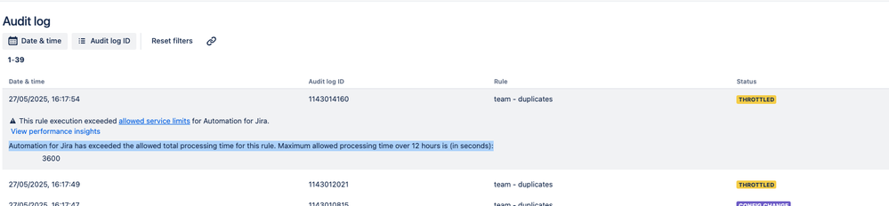

We cannot easily bulk edit the issues due to Automation Service Limits
