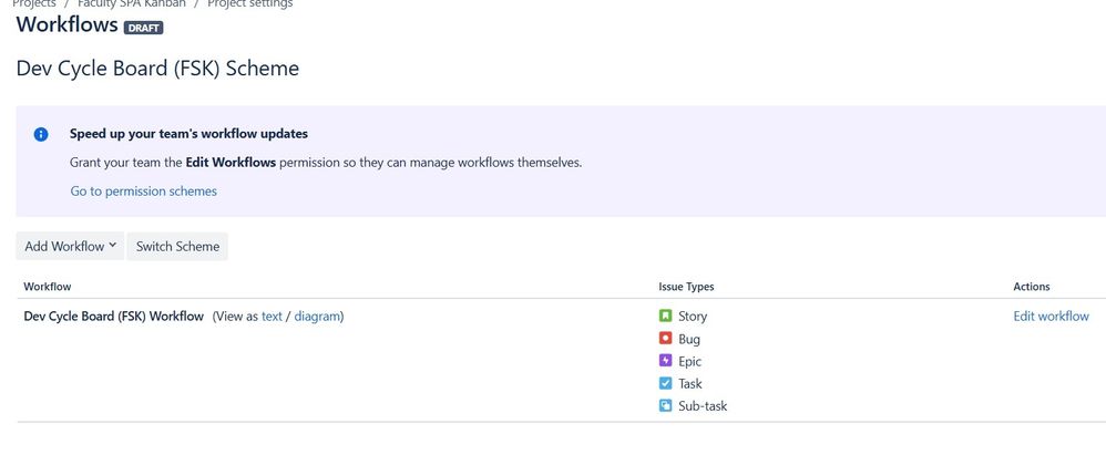

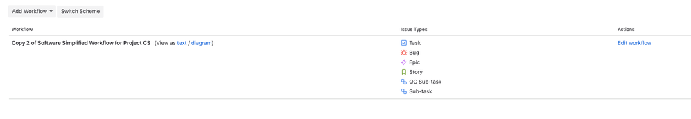

You can look at the Workflow Scheme for the project by going to Project Settings and selecting Workflows. If all the issues in the project use the same workflow you'll see information like this, naming one workflow and all the issue types.

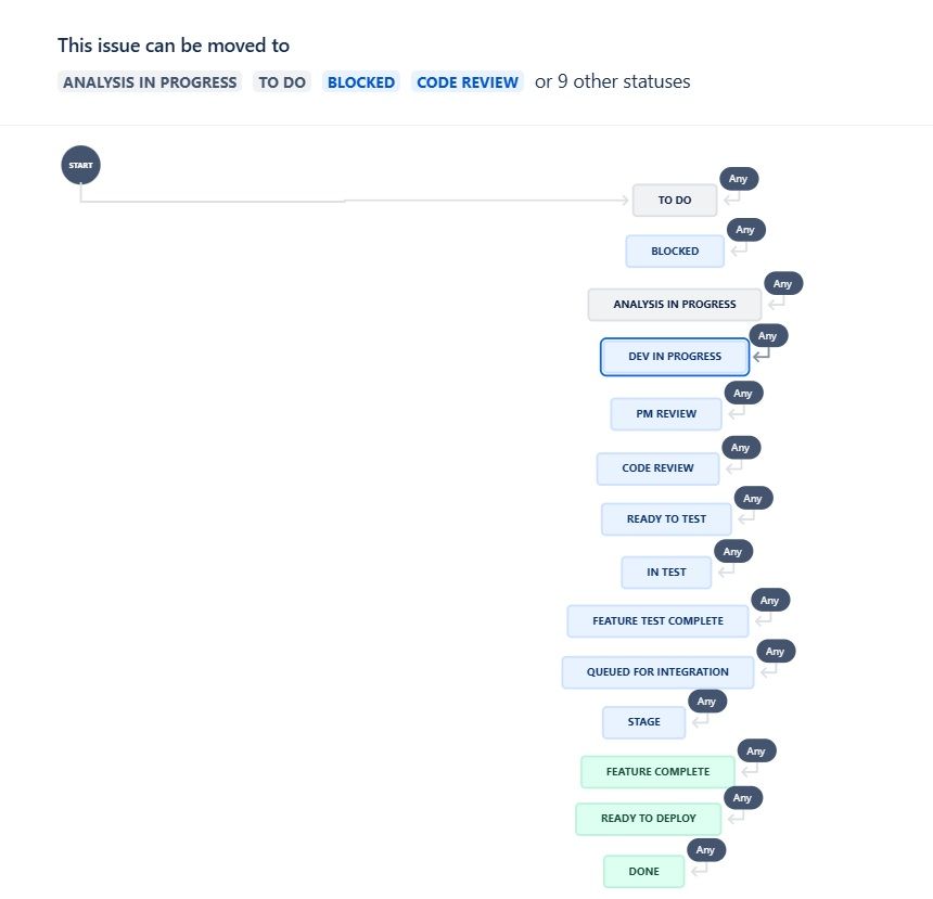

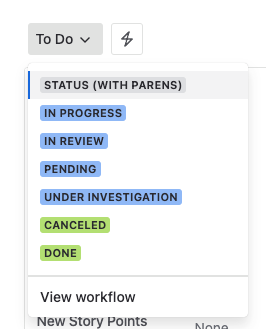

If you can share copies of the workflow diagram(s) that would be helpful. You can click on the Status button for an issue and you should see a View Workflow option at the bottom of the list.
That will display the workflow diagram associated with the issue type you are viewing.

As far as the workflow goes, that is what we are trying to figure out. I had suggested I create different issue types for dev tasks and QA tasks with different workflows but I'm not sure I could be successful pulling that off with the complexity of our board. This is what we have currently.
