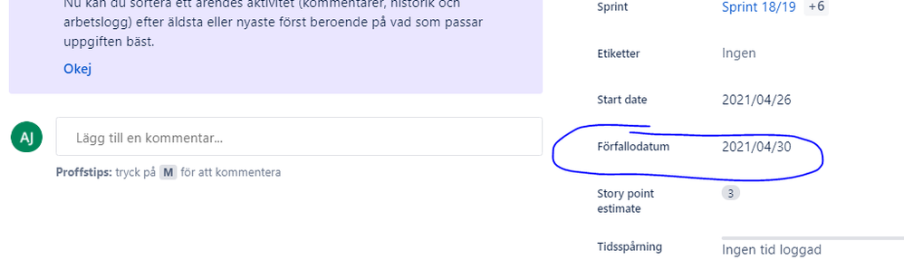

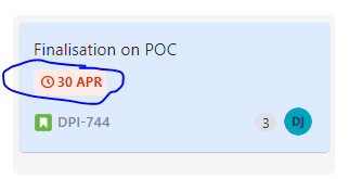

I have a Company managed software (Classic project) where I would like to work with Due dates. I would like it to look like this.
In the board:
In the card:
But right now I can´t find how to solve this in the board.
Can you help me?

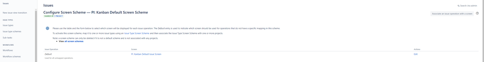

Is the field Due Date on the screen used in your Jira Project?
Go the project settings and choose for Screens and look at the configured view-screen.
Regards, Marco
Annie Johansson
April 30, 2021
This is what I can see. How do I proceed?

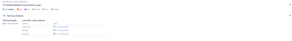

And can you click on “PI:Kanban Default issue Screen” and does the screen open? If so, can you add Due Date there?

I tried this but this is the only thing I see:

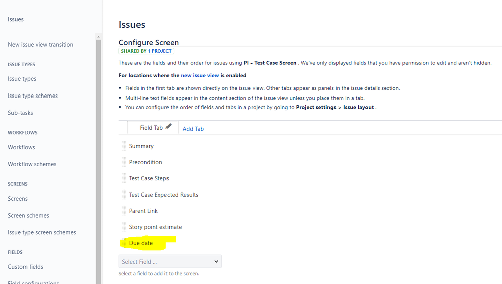

Marco Brundel
May 3, 2021
Hi @Annie Johansson ,
I don't think the type of board is the reason.
When you click on "PI - Test Case Screen" do you get a screen with fields?

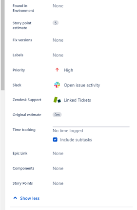

Annie Johansson
May 5, 2021
Now there is a Due Date, but I can´t find "Due date" or any field with a Date in the cards in the KANBAN:

Daniel Ebers
May 8, 2021
Could you please confirm if the "Due Date" is visible from "Field Layout" (please follow the steps linked here: https://support.atlassian.com/jira-software-cloud/docs/configure-field-layout-in-the-issue-view/)
It should be, at least for a test, listed under "Context field" - assuming "Due Date" is on the correct screen (you can check this even from the "Field Layout" configuration screen, on the top!) it should appear there.
...and...
Please also check if the field is by any chance hidden as per "Field Configuration" (you can find details here: https://support.atlassian.com/jira-cloud-administration/docs/manage-issue-field-configurations/)

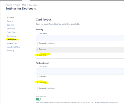

Marco Brundel
April 30, 2021

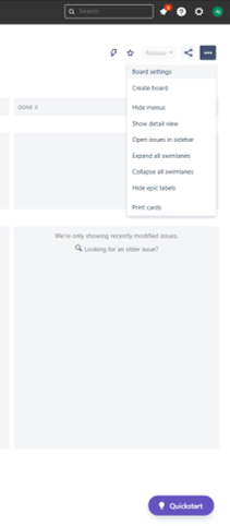

When you are on your board and choose for ... Board Settings and then for Card layout. In Card layout you can add fields to your cards.
Is this the option you're looking for?
Regards, Marco
Jack Brickey
April 30, 2021
And note that you are limited to three fields that can be added to a card.
Annie Johansson
April 30, 2021
Thanks Marco!
I tried this but I still can´t see the due date, neither on the car or in the card. Did I miss something? Please se below :)
Annie Johansson
April 30, 2021

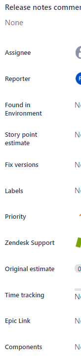

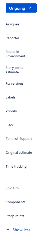

Thanks Jack!
Which fields are limitet and which are ordinary? Please see my screenshot below what I have today.
