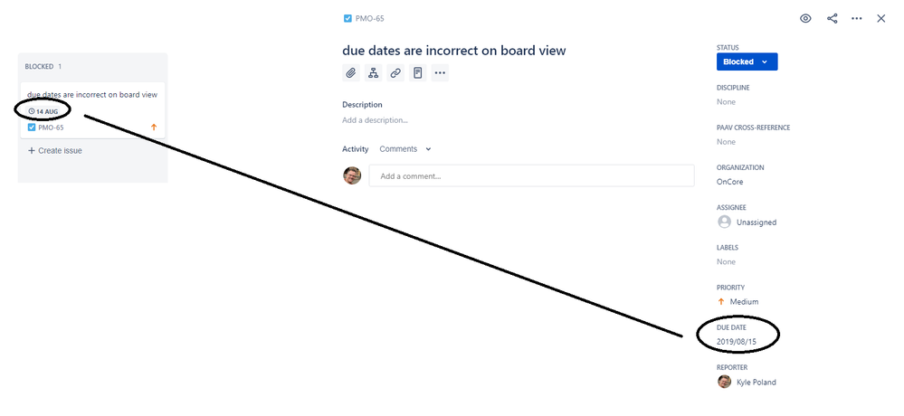

I have a Jira next-gen project with a kanban board.
I create an issue and set the due date to August 10, 2019 (which is displayed as 2019/08/10). Close the issue detail view.
The card on the board shows the due date as Aug 09 - instead of Aug 10.
as seen on the issue itself:
as seen on the board:
I submitted this to Atlassian support and it is a known bug in Cloud next-gen boards identified June 19, 2019. Watch this bug report if you want to follow it:

Yes. When I update the due date on the issue, the date on the card also updates but is still a day off. I am using a next-gen kanban board.
I did some more testing and found that this is only a problem on my next-gen board. On a kanban board showing issues from a normal Jira project the due date on the issue is accurately shown on the card on the board.

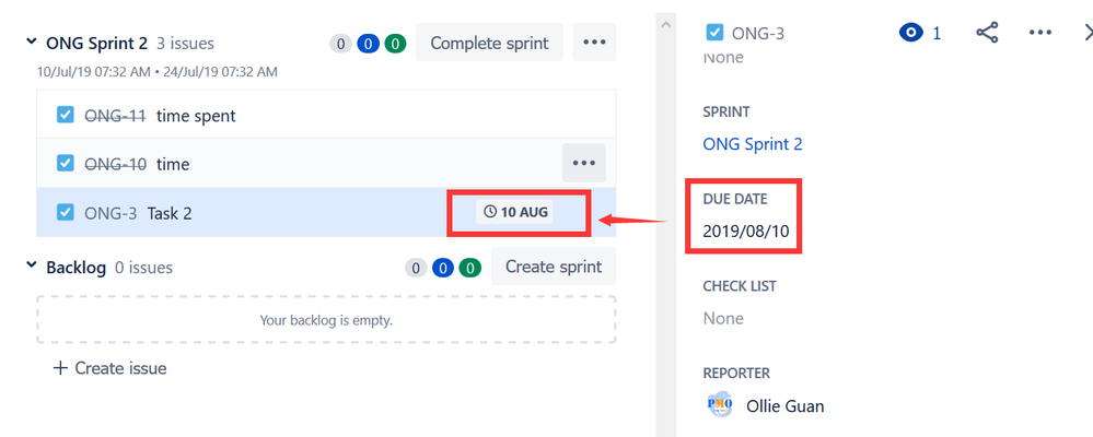

Hi @Kyle ,
If you create a new issue, will there be different due date at these two places?
I tried to test in my next-gen project, but I didn't find a similar situation.
Maybe you can try rebuilding the index to see if it can be solved.
If it still doesn't work, please contact the support team.
Yes, every issue I create new or old has the difference in due dates between the issue view and the kanban card view.
We use Jira Cloud which doesn't have a reindex option.
Thanks for your suggestions, I am opening up a support ticket with Atlassian.
