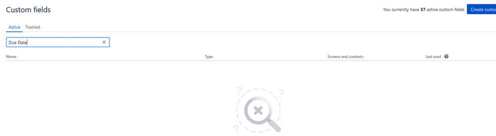

Due date field shows in default field configuration but not in custom field tab. I have never seen this happen before as it is an internal field.
There is only one default field configuration in this instance.
Why can't we find the field in custom field tab?

Can you provide an image of the "custom field tab" screen that you are viewing? It is unclear where exactly you are having the problem.
Aaron Geister
August 26, 2021

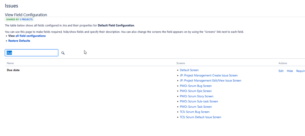

2021-08-26 13_22_47-Custom fields - Jira — Mozilla Firefox.png2021-08-26 13_23_26-View Field Configuration - Jira — Mozilla Firefox.png
If you look the custom field tab has no due date field, but the default field configuration does have it. I have associated to the correct screens but its weird that its not in the custom fields tab.
Trudy P Claspill
August 26, 2021
Due Date is not a custom field. It is a built-in field in Jira. Only user-defined custom fields will appear in the Custom Fields screen.
You will notice that Description, Assignee, Summary, etc. (other built-in fields) also do not appear in the Custom Fields screen.
