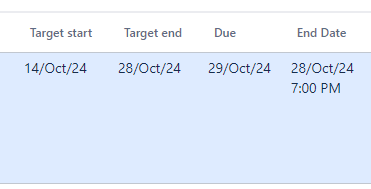

We have a Plan allowing users to edit the [system] Due date field. When an Initiative reaches a milestone, the Due date is stored in the End Date field so we have a baseline to compare against when the work is complete.
Doing a search for the updated Issue, the dates are different. The End Date appears to be 5 hours behind, presumably to adjust to CST. I assume this is because the difference between Date and Datetime fields. I've tried applying the addHours function (I'm Data Center) and even the cloud plusHours function, but neither seem to work.
Any advise is MUCH appreciated!

I guess I'm perplexed why there is a difference when using the smart value versus copying.

Unfortunately, using Jira template and cannot control date v datetime configurations.
The search results screenshot showed a couple date/datetime fields. Sorry if Target End Date lead to confusion.
While @Marc -Devoteam-'s solution worked, I'm curious how you could modify the value, instead of copying.
