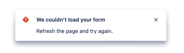

So i added a form, thinking lets go that route, and created a link, when i click it works perfectly (haven't created from yet, so will test that next), but my user when they click the link, they get
<!> We couldn't load your form

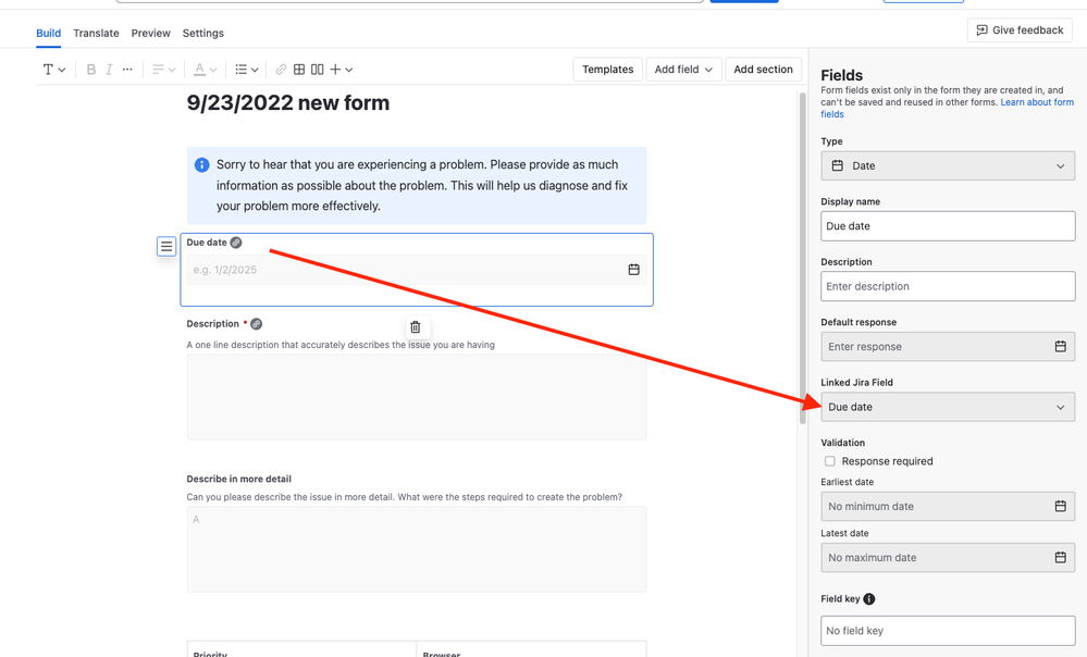

Regarding "You may also need to link the form field to the issue field named "Due date" otherwise the data will be only in the form attached to the OBR issue."
I'm not sure i know how to link the form field to the issue field, I don't see any options on the DD Field (in my OBR Fields) or from the screens/request form that offer anything that would allow linking.

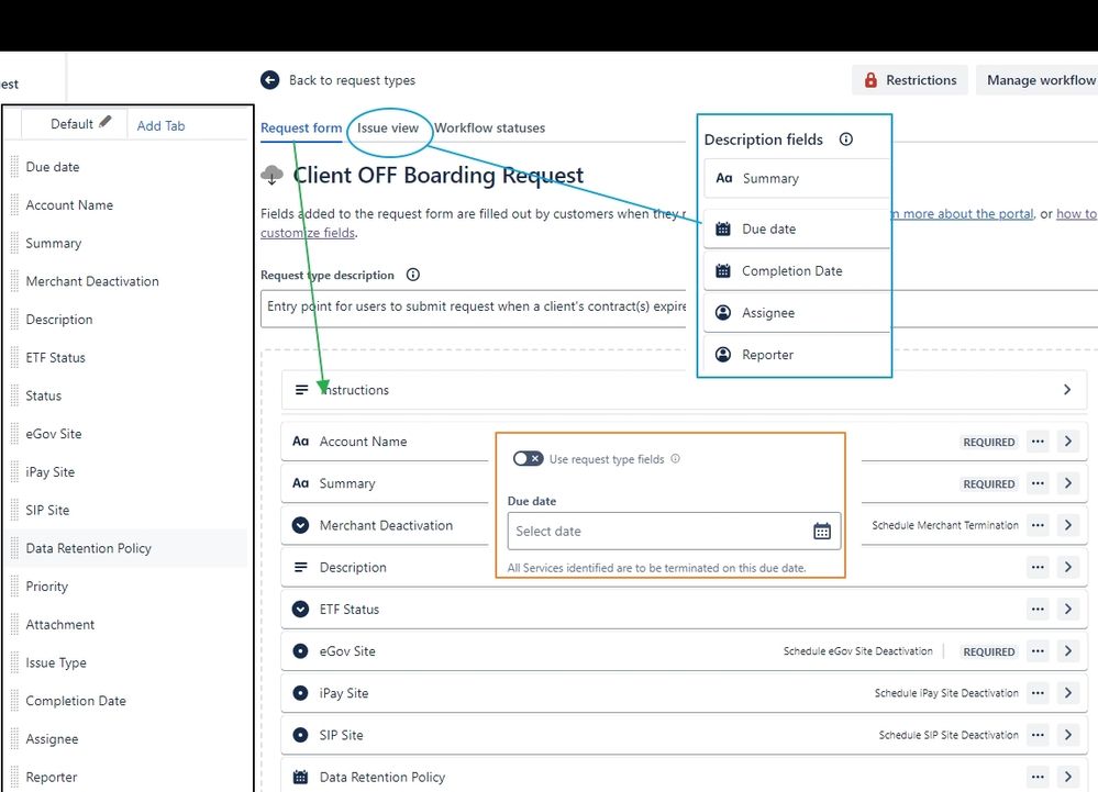

they access the from within Jira using the Create Button and choosing the OBR Project to submit a request. And the format they get resembles the "Screen" scheme, but why then when i choose the very same create button, i get the request form... How can i make so they get it?

I couldn't login as others to see what they see today (short staffed also) but based on the last observations, what they see mimics the Screen (black box, left side of image).
Whereas when I create, i see the Request Form (which doesn't currently show the DD), but toggling the "use request type fields (i)" option [Which i guess i'm the only one that sees this option] allows me to then see the DD field (see orange box) allowing me to see the Issue view effectively... But i'm the only one that can do that... Ideally i want the DD back on the request form, and i want that to be the form agents use (internally, no public portal access) to submit the request that triggers up to four events.

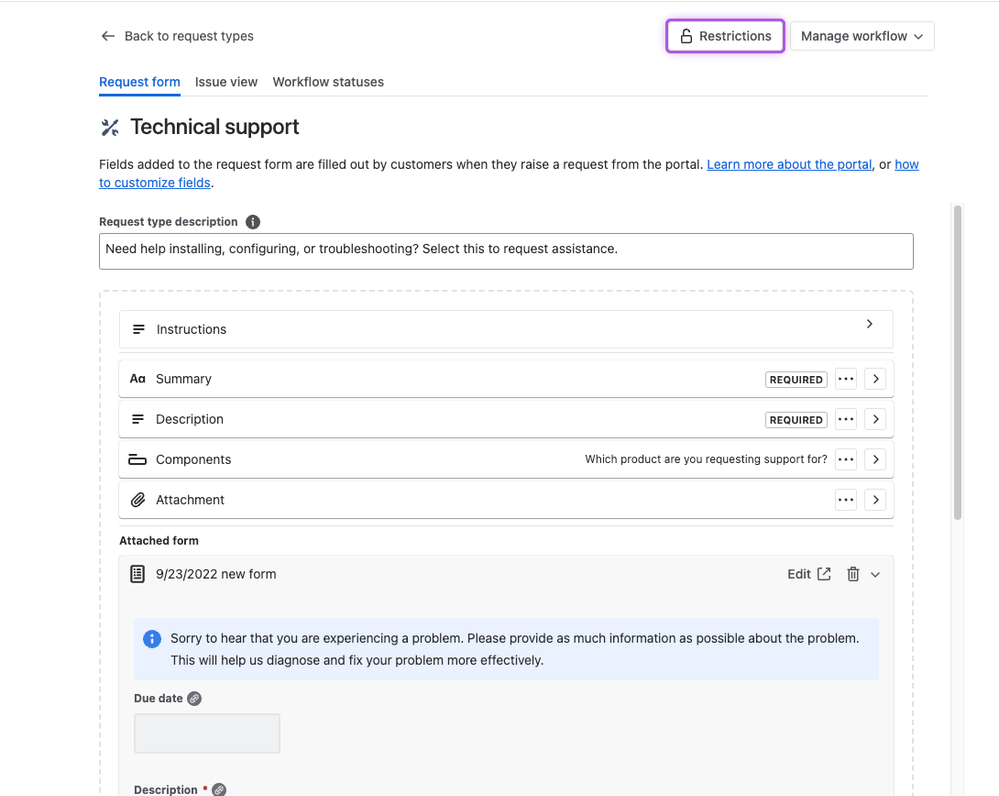

I created a request form in a Company Managed JSM project and attached it to a Request Type. When I go to the Request Types page (Project Settings / Request Management / Request Types) and click the specified Request Type, then I get a screen like you see with the three tabs at the top.
When I click on the Request Form tab I see that there are some fields listed at the top, and then below that there is the Form itself.
The fields shown in Attached form don't necessarily match one-to-one with the fields shown above.

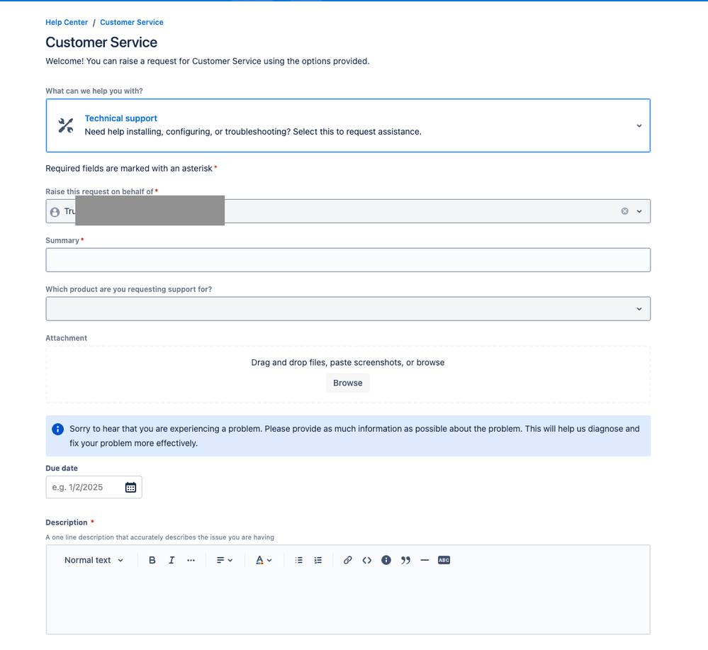

If a customer was raising the issue through the portal, then would see both the fields above and the form below.
If the agents are expected to use the form alone, not through the portal, then you need to make sure that the Due date field is actually on the form itself. You may also need to link the form field to the issue field named "Due date" otherwise the data will be only in the form attached to the OBR issue.
When you add a field to a form in JSM there is a field within that Field's configuration to link the form field to an underly issue field.

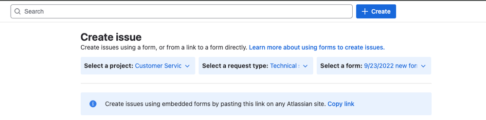

What is the link that you get (excluding the base URL)? i.e.
https://baseURL/jira/forms/create
I'm interested in the bold part that comes after the baseURL.
When you click that link do you see selection fields at the top of you screen for selecting Project, Request Type, and Form?

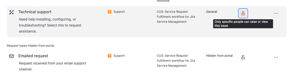

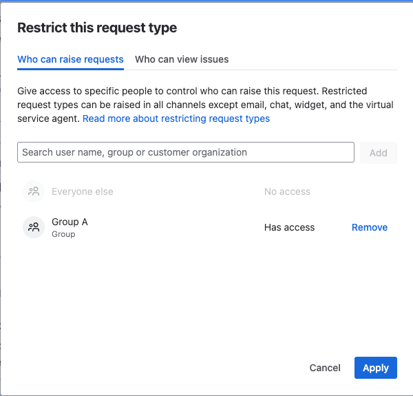

The form is related to a Request Type. If you go to Project Settings / Request Management / Request Types, and find that request type in the list, does it show a closed/red padlock or an open padlock?
And if it shows a closed/red padlock, can you click on that padlock to see what restrictions have been applied?
