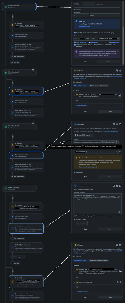

Here's the automation I have currently:

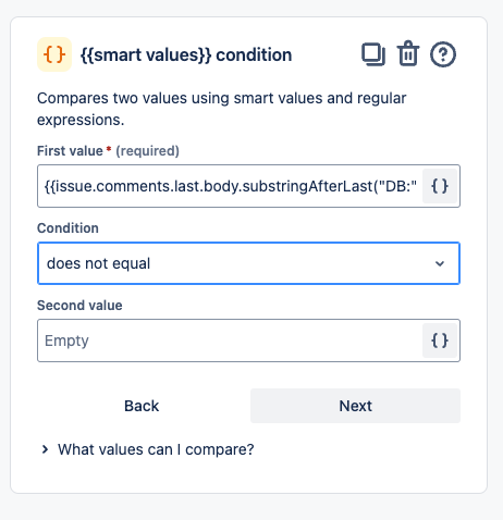

You should add validation to confirm that you successfully extracted something from the last comment. You can do that by adding a smart value Condition before your Edit action.

You have the rule running on a schedule, selecting only issues that have been updated since the last time the rule ran. And you are trying to pull the date from the "last" comment.
If a comment has been added to an issue, that will change the Updated date/time, and so the rule would select that issue. But if that last comment has nothing in it about the due date, then this rule would fail to get any information when it tried to extract such data from the comment. That would cause the Due date to be wiped out, since you don't currently have anything validating that you got a legitimate value from the last comment.

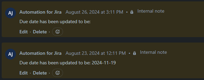

I see you have actions to add a comment to the issue noting the new due date. Are those comments getting added and do they show the correct value?
Unfortunately anything past the first comment did not, here's an example:
