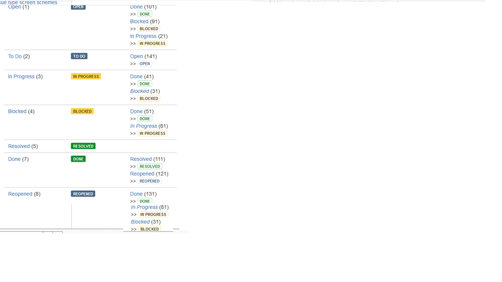

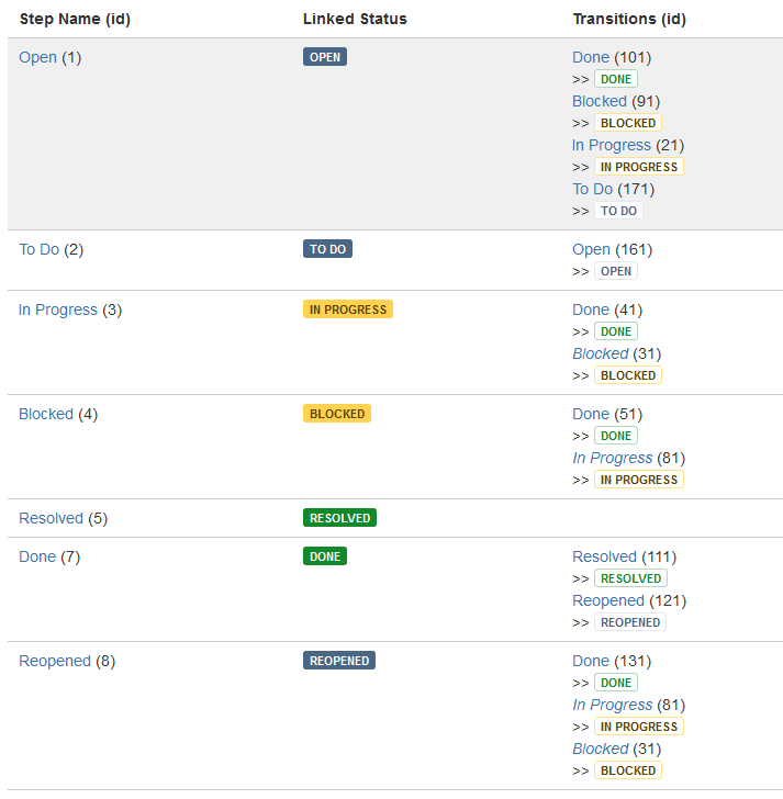

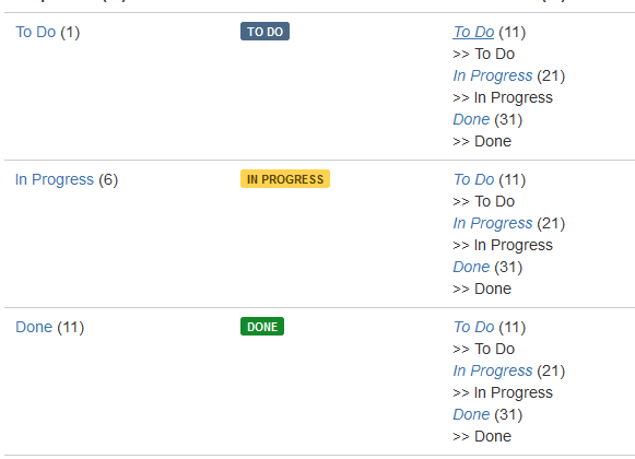

I created a new workflow for a jira project. Here are the 2 workflows our project uses.

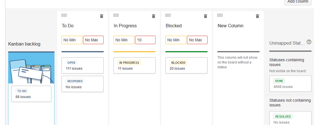

s.pngd.pngf.pngAnd here is the board:
a.pngI try to drag and drop issues from "To do" to backlog. I tried without reopened under to do column but it doesn't work.

Hi @Iro Karavasili
In your workflow, you do not have any transition from 'Open' to 'to do' status.
Add a new transition from 'Open' status to 'To do' status in your workflow

@Iro Karavasili , Did it add it to the 'TEST WF'? Can you share the latest screenshot?
Iro Karavasili
February 11, 2019
Fazila Ashraf
February 11, 2019
@Iro Karavasili , hmm, this should work now.. Could you go to your backlog mode and then drag the issue from the 'To do' (top) section to the 'Backlog' (bottom) section and see whether the status of the issue is actually changing?
