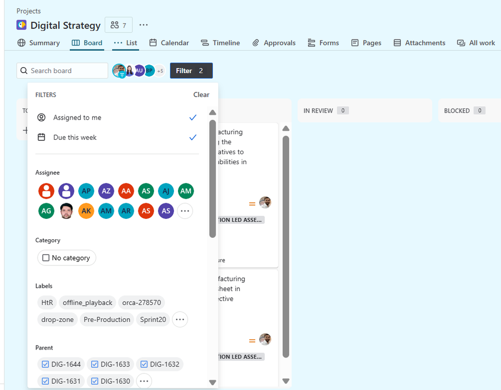

Hello folks,

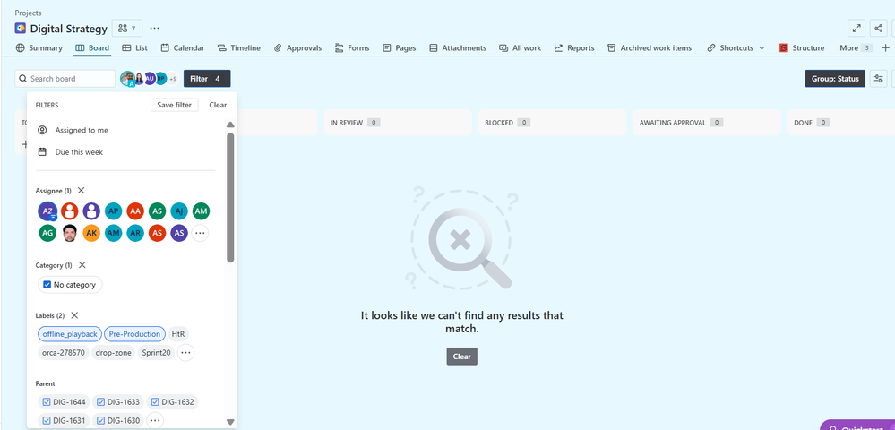

I am working on a team-managed project and I am having a hard time to apply filters. With reference to my attached screenshot, I am unable to apply filters on Due This Week and down below (like Assignee, category etc.). I can apply both filers at a time for 'Assigned to Me' and 'Due This week'.
Looks like there are 2 categories of filters (the first 2 and the rest below those) and its not possible to apply filters simultaneously in both the categories. Can anyone help me here?
More importantly, please advise how do I add more filters similarly to the above 2 (Assigned to me and Due This week). I want to add a filter as Due Date Range.

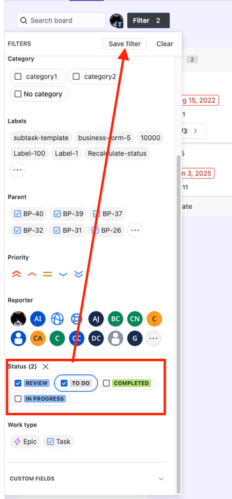

To create additional filters like the ones that show at the top of the filters dialog:
1. Select from the available options in the dialog to build your filter. The Save Filter option will then appear at the top of the dialog. Example:

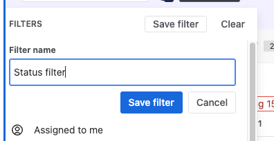

2. Click the Save Filter button and you will get a field to enter a filter name and another button to click to save it.

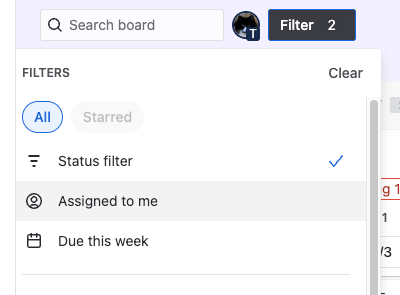

3. The filter will then be listed at the top of the dialog.

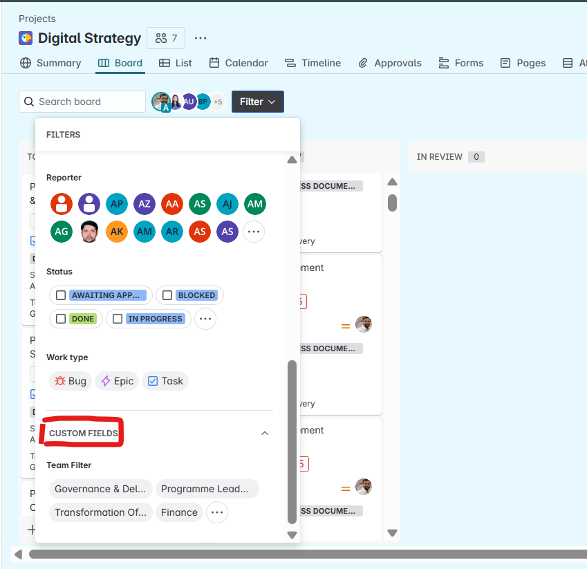

@Trudy P Claspill I was thinking to create a custom field of due date range and then use it in the filter section on board. But I am not sure how to do this.
Just an FYI, I created a custom field (Team Filter) which has all the team members of my project and that I see in the filter section on board. See the screenshot.

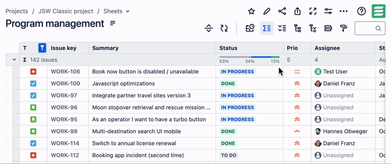

If I understood correctly, you are looking to apply multiple filters to a set of work items, including a relative date filter (e.g. Due date within next X days/weeks).
If you are open to solutions from the Atlassian Marketplace, you may want to have a look at the app that my team and I are working on, JXL for Jira.
JXL is a full-fledged spreadsheet/table view for your Jira data that allows viewing, inline-editing, copy-pasting, sorting, and filtering by all your work items' fields (and other data), much like you’d do in e.g. Excel, Google Sheets, Smartsheet, or Airtable.
To filter by multiple dimensions, just apply as many column filters as you need. All fields and custom field types are supported, plus lots of other non-field data related to work items. This is how it looks in action:

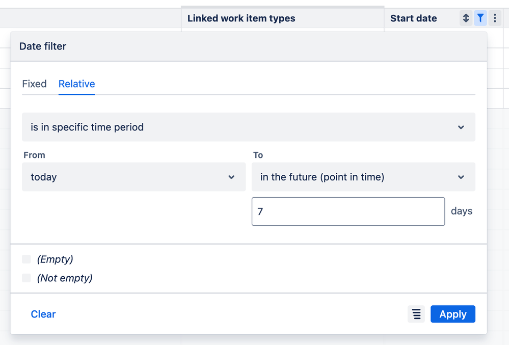

Date and datetime filtering is particularly powerful. You can choose between fixed, relative (and soon also periodic) timeframes, e.g.:
I should also add that multi-column filtering plays nicely in combination with all the other JXL features, such as configurable work item hierarchy, cascaded groupings by any fields, sum-ups, conditional formatting, and much more.
