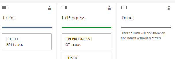

User is not able to view Done Status in JIRA. I recently started using JIRA, being an admin I did tried to find the reason however I couldn't.
I am not sure what could be possible reason. Even I tried to delete the Done column and then re-created it again. Still was facing the same issue.
Attached screenshot for your ref.
Regards,
Deleted user
July 7, 2017
Looks like you need to move the "FIXED" status to the Done Column. As it's trying to tell you, if there is no status assigned to a column, it will not display. Drag and drop "FIXED" into the column and it will show on the board. (I'm assumeing FIXED is your Done status. If not assign the status that represents Done for your project.)
Cheers!
Anup.Tiwari
July 9, 2017
Thanks Tom !! Its working now.
