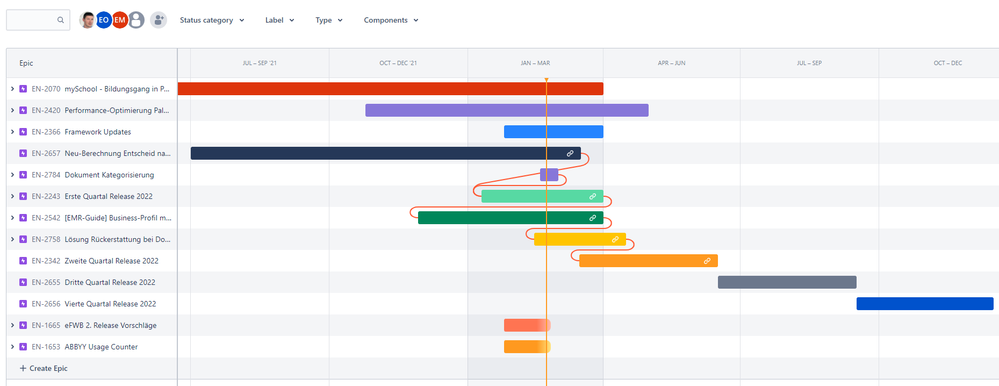

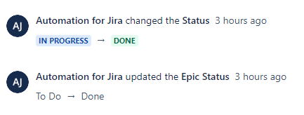

As soon as an epic gets updated to Done by our automations (when all childs are done):

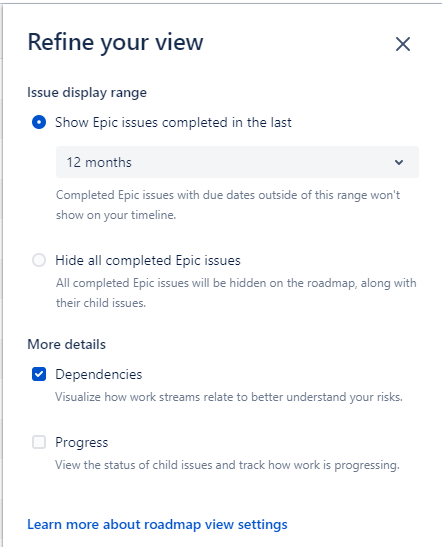

The epic isn't displaying anymore on the basic roadmap, although the settings of the roadmap view are as follows:
Any idea why that is? I've reviewed the filter used to fill the project board and the epic is still available in there.

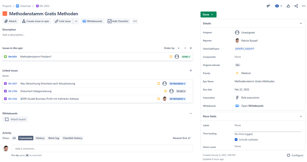

Hi @Patrick Russell ,
Could you provide screenshots of an affected epic and also of the roadmap overview? Maybe there are some more hints that lead to a solution.

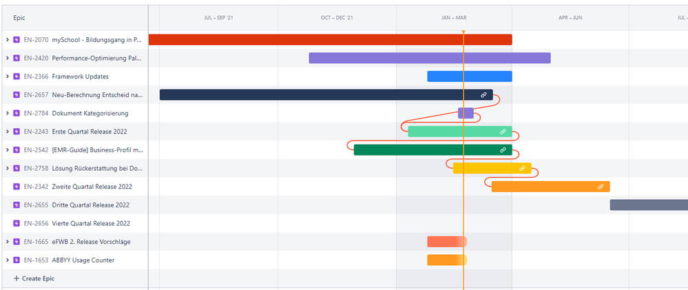

Patrick Russell
February 22, 2022
Here you go:
I hope it helps.

mkay....could reproduce the behaviour on my side.
explanation (of my setting)
there are 2 "kinds" of status for an epic:
  • workflow status
  • epic status
Epics in with workflow status Done are shown in Epic Panel and/or roadmap. As soon as I set the epic status to "Done" the Epic disappears from both views.

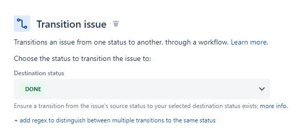

Patrick Russell
February 22, 2022
Which post was your source? I'm now looking at my automation and it only does this:
So it seems this sets both the workflow status and epic status to Done and I can't easily split them, can I?

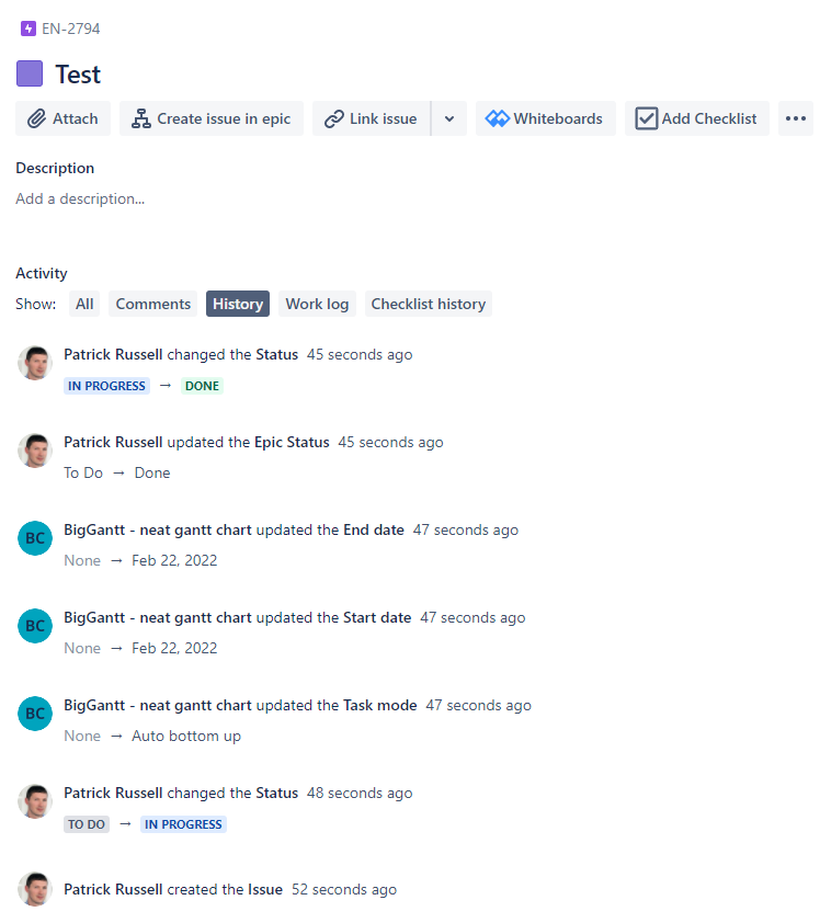

Patrick Russell
February 22, 2022
Looks like the epic status got updated as part of me changing the workflow status to done (as it jumped directly from "to do" to "done" while I was updating through the details page of the epic from "to do" to "in progress" then "done", so no confusion possible on the field I was editing:
And indeed it was a post-function, thank you again.
