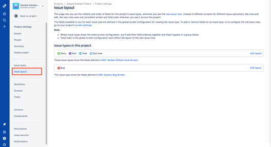

Angélica Luz
May 9, 2019
If you are using a classic project, the sidebar of the project settings should look like this:
Also, please check on Jira settings > Issues > Custom fields > Search for the field you create > ... > Screens > Check if the field was added to the desired screen.
The sidebar of a next-gen project settings is this one that has few options:

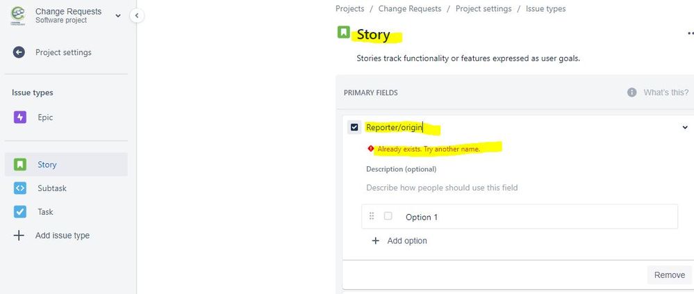

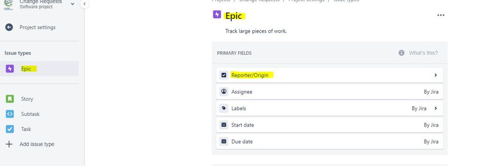

Hi, I have a new gen project. I added a new field on Settings as shown below (https://livngroup.atlassian.net/projects/CR/settings/issuetypes/10409)
However, I can see this new field only on Epic type tickets.
A Story or Task does not show this new field. If I try to create the same field on Settings->Story or Settings-> Task, it says "already exists". Shown below:
Please help.
Thanks,
Elma
Angélica Luz
May 23, 2019
Hi Elma,
The fields that you create on a project should appear on the right sidebar on the Previously created fields. This is a list of fields you created for other issue types.
Can you check if it shows the Reporter/Origin field on the list?
Regards,
Angélica
Elma Kurian
May 23, 2019
Thanks Angelica. Yes it shows on the right. All good.
