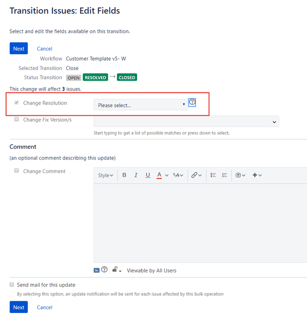

Don't force a change in "Resolution" when Bulk transition issues to close
Christina Fausbøll
May 31, 2018

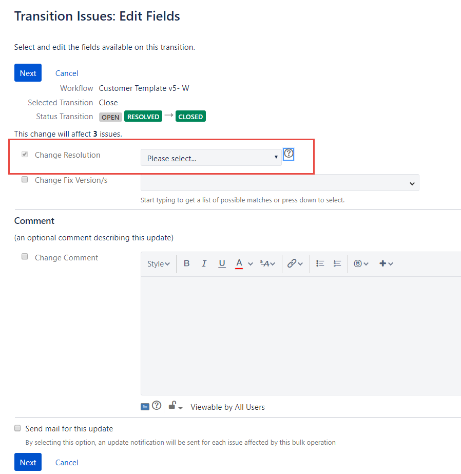

When I bulk change issues and transition them though our workflow from Resolved to Closed ( to remove them from my boards") i would like my issues to keep the resolution code they already were set with, when I resolved the issues.
But as it is now, I have to Change the Resolution when i move the status. I can't unmark the "Change Resolution" and I need to choose a new value, which overwrite the value that the issue already has.
Does anyone knows how I can change this, or if it is possible.

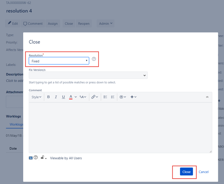

When I close the issue from the issue card, the resolution option is kept, without a force to change.

I don't think this is the correct answer or at least it is incomplete. You should not make the Resolution mandatory in the Field Configuration screen. As Nic so eloquently put it below...
NEVER do that.  And in a similar vein, NEVER put the resolution field on any screen other than a "transition to a closed type status".
If you make it mandatory then it is ALWAYS required and that includes bulk update. There is no way to avoid other than not make it required which is the proper solution.

Your screen shot implies you have made the resolution mandatory in your field configuration.
NEVER do that.  And in a similar vein, NEVER put the resolution field on any screen other than a "transistion to a closed type status".
(Well, not quite "never", there's a couple of edge cases, but for most Jira systems, it breaks it completely)

Yes, there is a bit of a problem.  Jira has a simple flag for "resolved" - if the field is empty, an issue is unresolved.  If the field is filled, the issue is resolved.  That logic affects dashboards, reports, searches and the display of issues in a lot of places.
You need to make your workflow and edits account for that.  Even if you never ask your users to fill a resolution, you should set it in the workflow appropriately, so that resolution is set or cleared correctly.
A properly configured Jira will:
Not have resolution on any screen other than ones used for transitions
Have resolution set as optional
Set the resolution on going into "closed" type status (generally, the ones you've got in green), either by offering the user a screen with resolution on it, or by post-function
Clear the resolution when going from a closed type status to an open type one (green to blue or yellow)

The solution we went with, was to remove the field " resolution code" in our workflow in the transition between resolved and closed. Because we set it when moving the issue to resolved.
So @tom, we got around it by removing the fileds in the transistion. So we are doing as @Jack Brickey suggested.
At the time I asked this question I didn't know that this was why the field was mandatory.
We have transitions moving directly to closed, but when using these we are asking for a resolution in this transaktions, so i will be filled out, without passed the status resolved.
