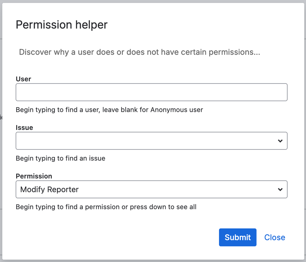

Rohit Utukuri
May 8, 2026
Hi @Kodidasu Lavanya ,
If it is a company managed project, there is a permission helper which can help to determine if a specific user has permission.
Project Settings-> Permissions -> Permission helper
Kodidasu Lavanya
May 8, 2026
Thank you @Rohit Utukuri  for sharing this information. This is very helpful.
I will check the Permission Helper in my project to confirm whether the integration user has the Modify Reporter permission and proceed accordingly.
Thanks again for your guidance.
