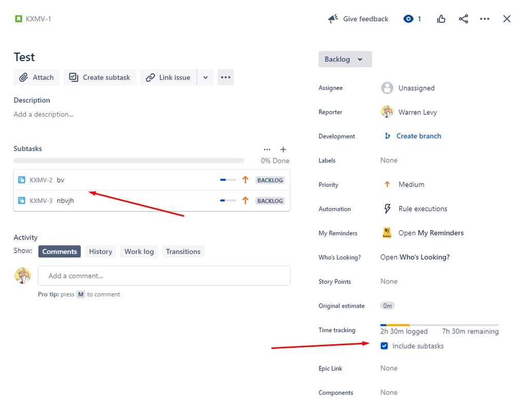

Could you maybe point me to where I can find this Include subtasks checkbox? I'm currently using the new issue view on Jira cloud.

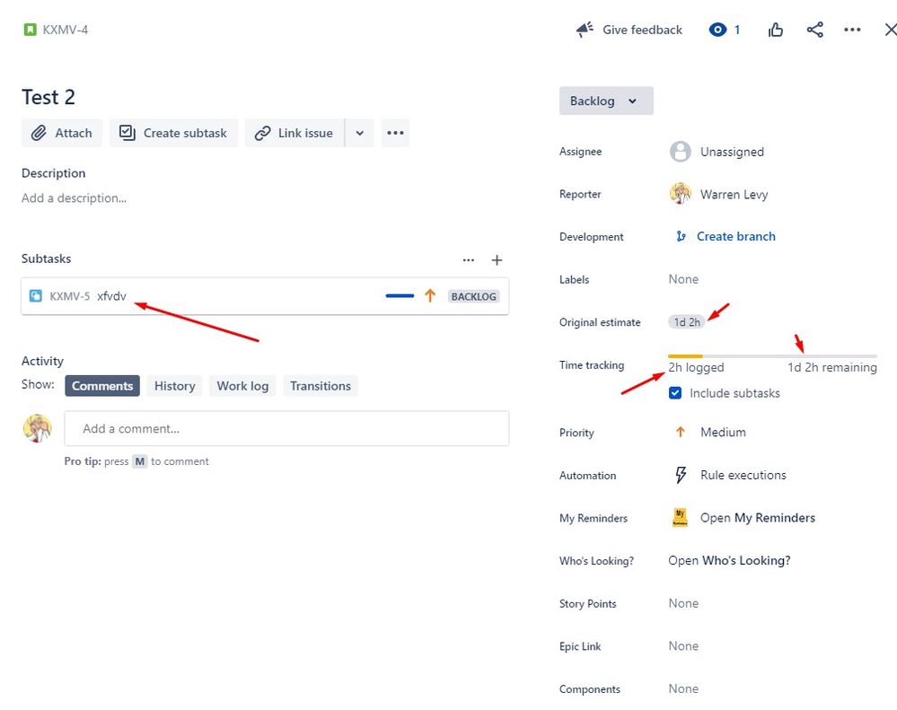

I'm also wondering if this still works if only the parent has an estimation? So let's say the parent has an estimate of 10h and I log 2h on a subtask, will this just lower the parent to 8h? Or does this only work when the estimation is done per subtask?

If you look at the screenshot below, this shows a parent item with no estimate, and 2 subtasks each with an estimate and some time booked against them. It shows the check box and the summed up remaining time, as per my description above.
I tried what you asked, I created a parent and put a 10h estimate on it. I then created a subtask and logged 2h on the subtask. As you can see below, it shows the 2h that was logged, but doesn't reduce the estimate of the parent.
