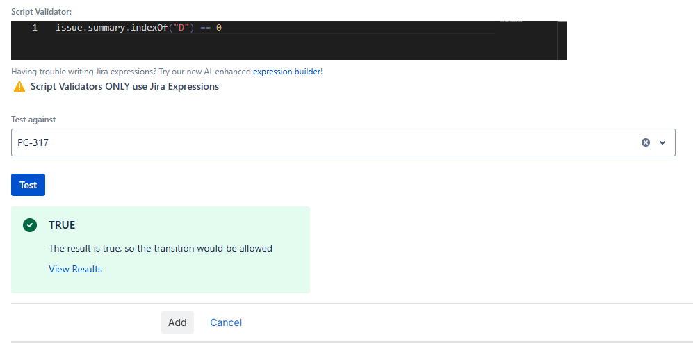

@Martin Kay just in case, I've got indexOf() working. The mistake was with the === operator. It's needed to be just double one: ==
With kind regards
Slava
