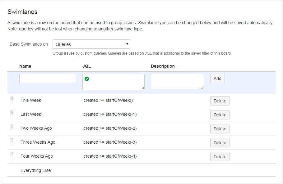

Epics is a good way to go, and has some advantages, specially if you need to report on a per week basis (Epic Report) and/or consistently estimate issues (sum up of story points per epic).
Alternatively, and depending on your exact needs, you may prefer to configure several Swimlanes based on Queries, which would display issues ordered in dynamic weeks:
Note that issues will be displayed in the first swimlane from top to bottom which would have been returned by its query.
You might want to create those swimlanes from last to first, so that you get the correct order of swimlanes with no need of reordering them with drag & drop.
The advantage of this approach is that it doesn't require you to perform any actions (further than the one-time configuration of swimlanes) to have issues ordered by week.
Alternatively to using the created date, you might want to use the due date instead, which would also be configurable to use future dates for planning.

It did - makes much sense to do this, and to use duedate against endofweek()
