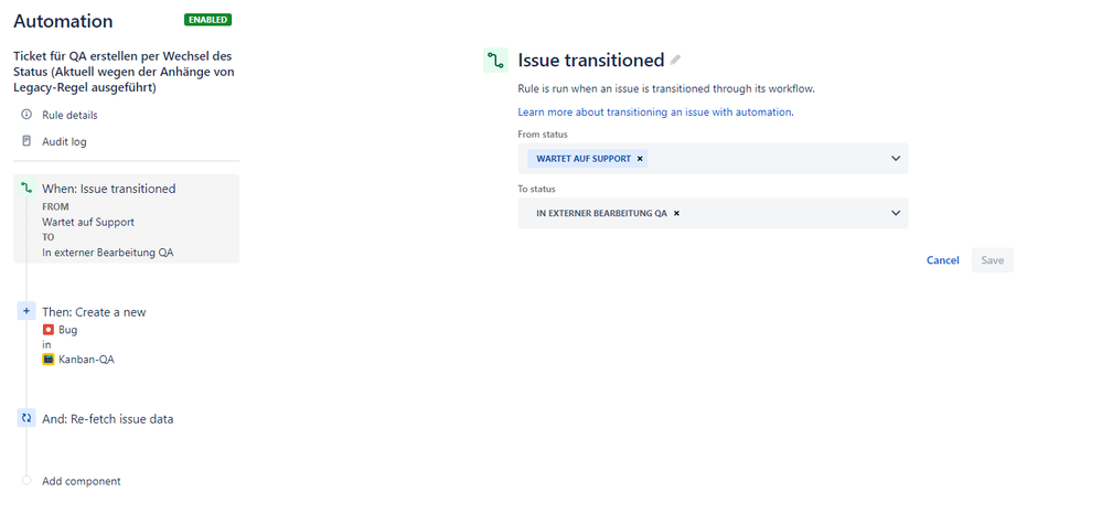

Assume we have status A and status B. There are two transitions from A to B. One called AB1, and one called AB2.
I'd like to trigger an automation rule when an issue goes through transition AB1, but not when it goes through transition AB2.
Is this possible with Automation? Currently, I don't see an option (see screenshot) to distinguish between specific transitions when there are multiple transitions between the same status pairs.
Mikael Sandberg
April 15, 2021
It would only be possible if you set a custom field that identify which transition was used. Automation rules runs after the transition is done (after data is written to the database).

Chris Fortmueller
April 16, 2021
Thanks @Mikael Sandberg @Bill Sheboy
I was thinking about the custom field solution as well, but thought maybe there is a simpler way.
