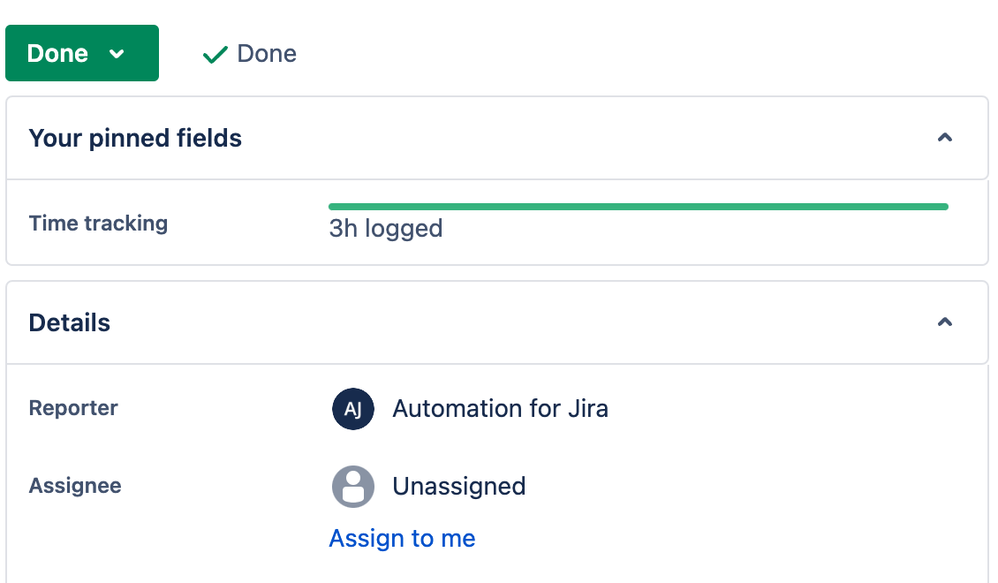

The current time spent (sum a of individual worklogs) is visible in the issue detail view. Why would you want to add it to a transition screen? To my knowledge, that's not possible.
If you change the issue layout to have the Time tracking field above the --- HIDE WHEN EMTY --- divider, you can even pin the field so it's visible on top.

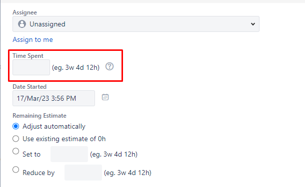

I'm asking this why:
The user must be sure to fill in the time of the task.
He can specify it during the transition, this is ok.
But he can also specify the field time tracking in the task itself. In this case, when transitioning, validator will give an error, since the transition time tracking is empty. But in the task itself, it is not empty. And the user needs to specify 0 hours during the transition.
Accordingly, this is strange, because in theory validator is simple, I want to check the value - time tracking, and if it is not empty, then it will give an error.
On the one hand, I understand the logic so that the assignee can enter the time at different stages. This is convenient when the task is transferred from assignee to assignee.
But when only one assignee is working on a task, it is confusing, if you specify the time in the task itself, and then ignore the time tracking field when closing, it will give an error.
