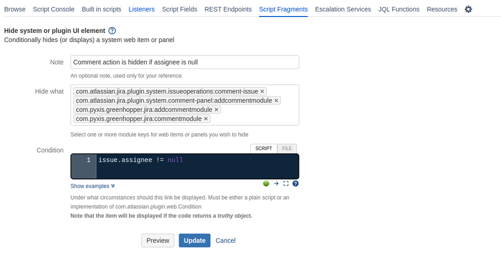

Hi @t3knoid I do not think it is possible. Status property is set as part of Workflow EDIT process, changes must be published and what is worst, status property is relevant to all issues using the workflow (so it would be applied to all the issues, not only to the unassigned).
I think you could use Script Fragments (https://scriptrunner.adaptavist.com/5.5.9/jira/fragments/HideUIElement.html) (if you have Script RUnner installed). I tried it in outdated version, but it should be quite similar in the newer version.
