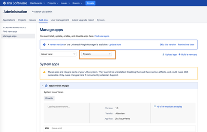

When your doing your search can you verify that you have either "All" or "System" apps displayed in the field highlighted here:
If the plugin is missing from the list check the filesystem at the path relative to your jira-install directory: $jira-install/atlassian-jira/WEB-INF/atlassian-bundled-plugins
make sure the jira-view-issue-plugin-7.13.1.jar is present in the directory, If it is missing you have an issue with the installation and something failed either during the initial install or an upgrade, and Jira should re-install, and data recovered from a backup as there would not be an easy way to narrow down everything that may have failed to deploy.
If the file is present there could be an issue with the filesystem permissions, verify the directory permissions are correctly set and restart the application.
For a Linux OS, Additional details can be seen in "How to fix JIRA Directories permission in Linux",  and for Windows you need to grant read & write access to the home and install directories for the user that the Jira service runs as. Check the Jira Service to see which user that is.
