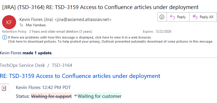

Our Jira admin transitioned to a different role. The admin was given to me. I'm still learning as I use it everyday. I just have this issue that we keep getting an email from the from this user every time that we modify, closed or resolved tickets. Please see screenshot below.
Kevin Flores (Jira) <jira@axiamed.atlassian.net> How can I can change that name so It will reflect my name instead of him? I already looked the email notification but I was not able to find that settings where to change that name.

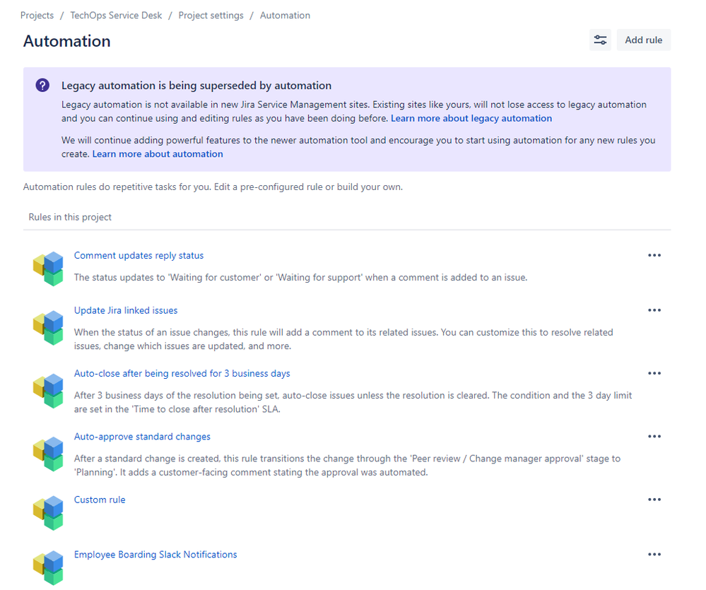

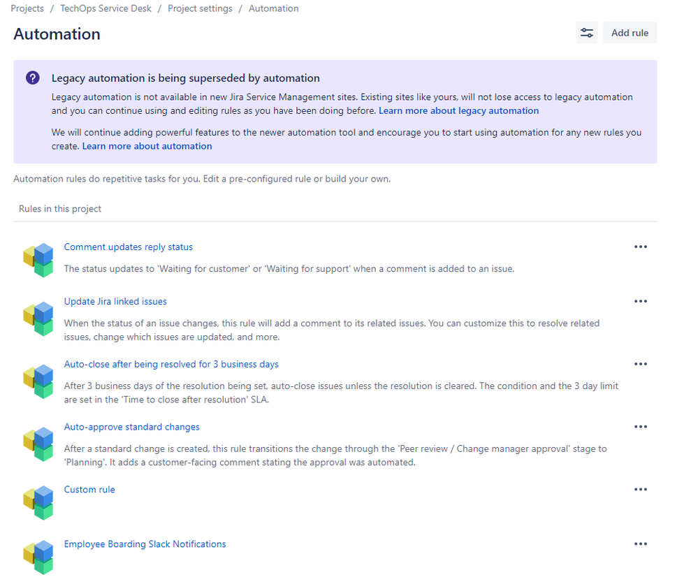

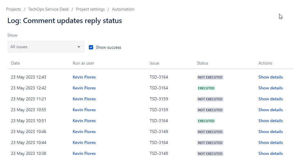

I looked at the project Automation and you are correct, it looks like Kevin created some rules that is using his name Kevin Flores. The first screenshot are the rules and second one is the account that runs the rule. I hope I'm on the right track here. If so, can I change the Run as User to my name?
Hello Trudy, Yes that is the screenshot. I would like to change that to my name so that the email recipient will see "Mar Yambao (Jira) <jira@Axiamed.atlassian.net> instead of Kevin Flores. Everytime I make a change on the ticket, that email address sends me an automated email. sample below: I was not able to located where to change. that.

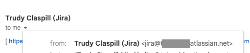

The Name shown next to the email address and the name shown for who made the change should be the name of the person who actually made the change. For example a change I made recently resulted in this email:
The name shown should match the Name associated with the individual account that made the change. That is why I asked you to double check that the Name (not the email address) shown in your account is actually your name.

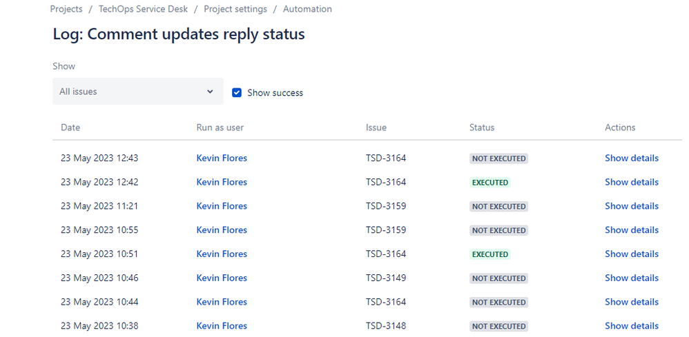

As what you have suggested, I checked the Automation and found these rules that I think Kevin created. When I click on on View logs, I can see Kevin on run as user. Let me know if I'm on the right track. I'm not sure if these rules that triggers the email that I was talking about. If so, can I change replace the run as user to me so it will reflect my name on the email instead of Kevin?

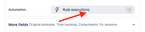

For one of the issues where you received a notification that Kevin made a change, you can confirm if a rule executed against that issue by:
1. Viewing the issue details.
2. Clicking on the Rule Executions in the Details panel on the right.
That will show you a history of rules executed against that issue. It will also have a link to the rule that you can click on to go directly to the rule that executed against that issue.
If the rule causes some change that generate an email notification, then the notification will say the change was made by whomever is specified as the Actor for the rule (in the Rule Details). If you have sufficient permissions you can update the rule actor. Note though that the rule actor must have enough permissions to execute the tasks specified in the rule. If the actor does not have sufficient permissions to execute those actions, then the rule will not operate as expected.
