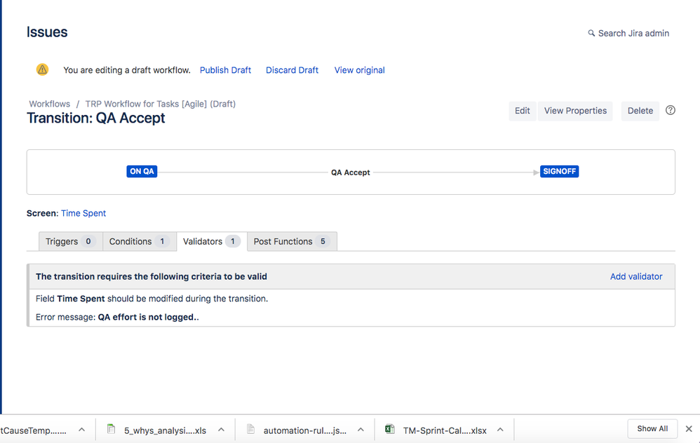

Hey Guys,
I've had difficulty setting the validation for if field value is modified during a transition. What've done so far is, added a validator from QA to Sign Off wherein if time spent is where I've added my validation i.e from transitioning to QA  to Sign Off time spent should be entered/updated. I get the alert if the time spent is not updated. However, I'm still getting the alert even if the time spent is entered in this transition. I tried adding screens too but that also didn't work.
Any possible solutions for me?

Hi Anand,
I tried to recreate your validator problem here.  Something I noticed here, you can set a validator on the system field called 'Time Spent', however on the transition screen you will need to make sure that you add the system field called 'Work Log' in order to make this 'modify field value validator' functional.
With most other fields in Jira the name of the field is the same in both validator and screen, but for the sake of time spent, this is being measured off the Jira work logs.  Furthermore, in this case you would have to place this Work Log field on a transition screen.  A transition screen is the only way that this validator could work properly to allow users to enter/change a value when the issue is transitioned.
I hope this helps.
Andy

Hey Andrew,
It worked perfectly fine. I think the other mistake which i was doing is, under screens, i had added time tracking instead of log work.
Thanks a ton:)

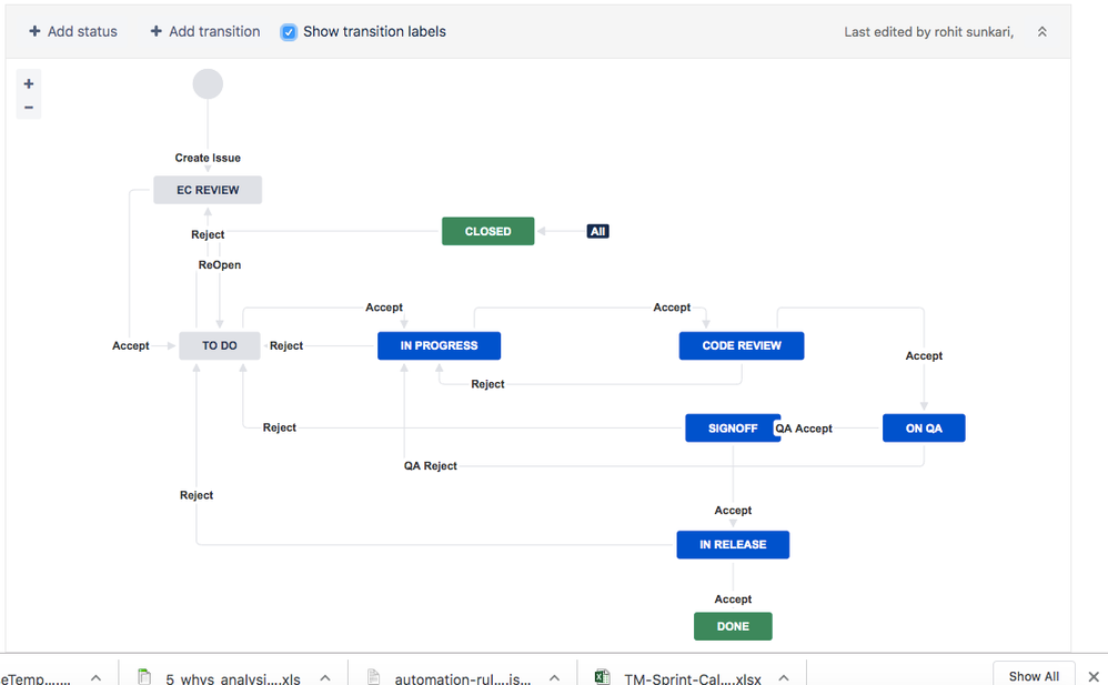

I understand that you are having a problem with a validator in your workflow.  However I'm unclear of the details here.  What field is using the QA and Sign Off values?  Could you post us a screenshot of your validator settings?  I might help us to better understand your specific environment and this situation to be able to offer more help here.
Thanks
Andy
Anand Vardhan
May 19, 2019
Hey Andrew,
Thanks for the update!
I'm attaching two screenshots. One for the workflow and other for the validator. I've added the validator when the issue is being moved from QA to  Sign OffScreen Shot 2019-05-20 at 11.09.39 AM.pngScreen Shot 2019-05-20 at 11.10.18 AM.png
