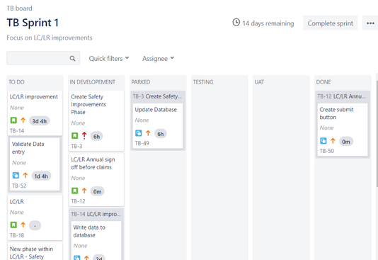

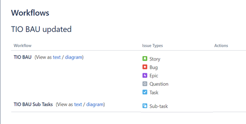

Hi, I have set up the following workflows:
Created some stories and sub-tasks and move a few along their workflows then when I view the agile board both workflows have been merged into one:
TIO BAU Workflow is ToDo->In Development->Testing->UAT->Done
TIO BAU Sub-tasks workflow is YoDo->InDevelopment->Parked->Done
I am looking to have two boards, one for each workflow and if possible the sub-task workflow to group the sub-tasks by parent story.

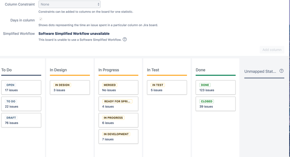

Separate boards aside,  I encounter a problem when using the single board so as to have a single source of truth/view of work flow across a team when using "stories" & their WBS in the form of "subtask".
I have coherently mapped the possible states of  "Story" & "Sub-task" into desired columns when configuring the Board.  However as soon as I instantiate a Story with a Subtask, the board re-flows that story out of its current context & priority order for execution/flow and sets it apart into its own swim lane for that story.  This is wrong on multiple levels for any execution team
 - for one breaks the order of stories/tasks/bugs that they will likely have agreed at planning and thus the visual representation on the board
- The swim lane sets the "Story" in the "ToDo" column when right next to it it echos back the "In Development" state.
- What is the value of mapping the states for the jira types story, task, sub-task if they aren't respected by correctly landing the item in the corresponding column when using them as a combination (story & sub-task)?
Have I missed something with the board configuration to have this effect?
  - I have included the view of my board configuration, incase some one can better reason than I have been able to for the resulting view.
Here is my Board configuration for the column/states

Not quite what I expected. I have created two separate workflows, one for sub-tasks and one for the rest. I create a series of subtasks under a story, the end result is both workflows are merged into one where you can only move the sub-tasks to the columns that were part of its dedicated workflow.
I am looking to have two separate workflows, one for the devs to move the tasks through the development phase (preferably grouped by story or an easy way to see what story the tasks belong to) and one to move the stories through (e.g. testing, PO review, UAT etc).
Can this be done?

if you have two WFs and you want one to apply to the Story and the other to apply to the sub-task then you simply need to assign the issue type to the appropriate WF.
Story = WF1
Sub-task = WF2
i must be missing something?
