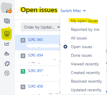

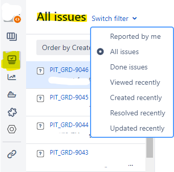

Hey Atlassian Community,
When I maneuver to "Issues" in one project, it shows me this:
and in the other project it shows me following:
I checked both configurations and couldn't find any significant differences.
I have problems to understand why one project shows "My open issues" when I switch the filter but the other doesn't.
Thanks in advance.

Steve Long -Evelon-
May 15, 2023
Hi @Naqibullah Azizi
'My Open Issues' is issues that are assigned to yourself.
So, my guess here is that you happen to have issues assigned to you in one project, but not the other.
Hope that helps - Steve.
Naqibullah Azizi
May 16, 2023
Hi @Steve Long -Evelon-
That was my first thought too, but both projects are not assigned to me. I just manage them as a system administrator.
The user who is project manager (with similar roles) for both projects has the same "problem".
Regards
Naqibullah
Steve Long -Evelon-
May 16, 2023
@Naqibullah Azizi have you also checked the project permission schemes, to see whether you're part of the 'Assignable User' permission in one project, but not the other?
Naqibullah Azizi
May 17, 2023
Hi @Steve Long -Evelon- ,
thank you for the response.
Well, I'd checked it and they are the same (shared) permission scheme :(
I have no clue where the difference might be or how to force this filter.
Naqibullah Azizi
September 20, 2023
We found the reason:
- missing "Resolution" field in the effected project
