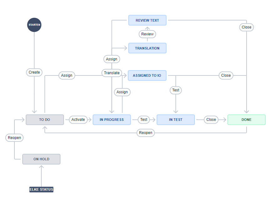

Hi,
I have changed the statuses and created the workflow as below, but the statuses aren't corresponding to the statistics I want to use, not all are shown.
How can I change this?

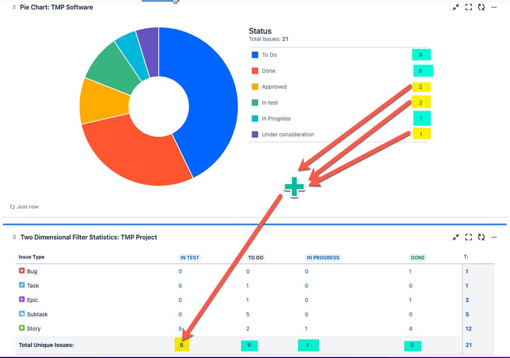

@Evelien.Roze  & @Nic Brough -Adaptavist- , this seems to be a bug to me.
Here is what I did:
  • Created a TMP project with six statuses
  • Created sufficient issues and place them into varying statuses so that I could better analyze the results in a pie chart as well as a two dimensional statistics
  • I added a pie chart and 2D gadget to my dashboard using the same filter. On the 2D I placed Status on the X and Type on the Y.
Here, is what I discovered.
  • Only four of the six statuses are displayed.
  • On the 2D table it shows a total of 5 issues in the "In test" status. However, there are only 2 issues in that status. Interestingly enough, if I click on the 5 there are only 2 issues displayed.
  • It appears that in the 2D chart it is adding in the other missing statuses. This is illustrated in the yellow highlighted Numbers.

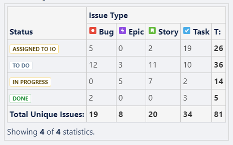

Hi @Jack Brickey ,

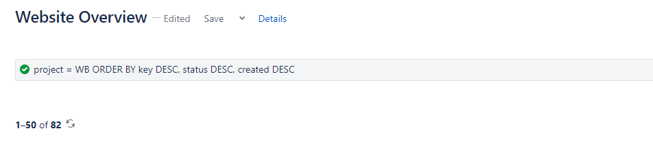

These are the details of my statistic:
This is my filter:
In my filter overview, I can see the other statuses:

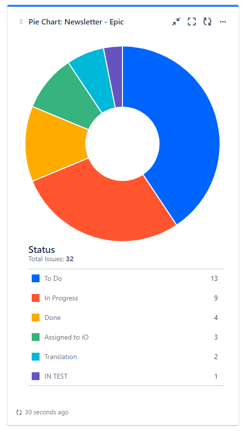

When I use a PieChart, it is showing all status:

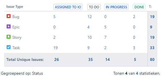

I can't seem to select all projects using this statistic.

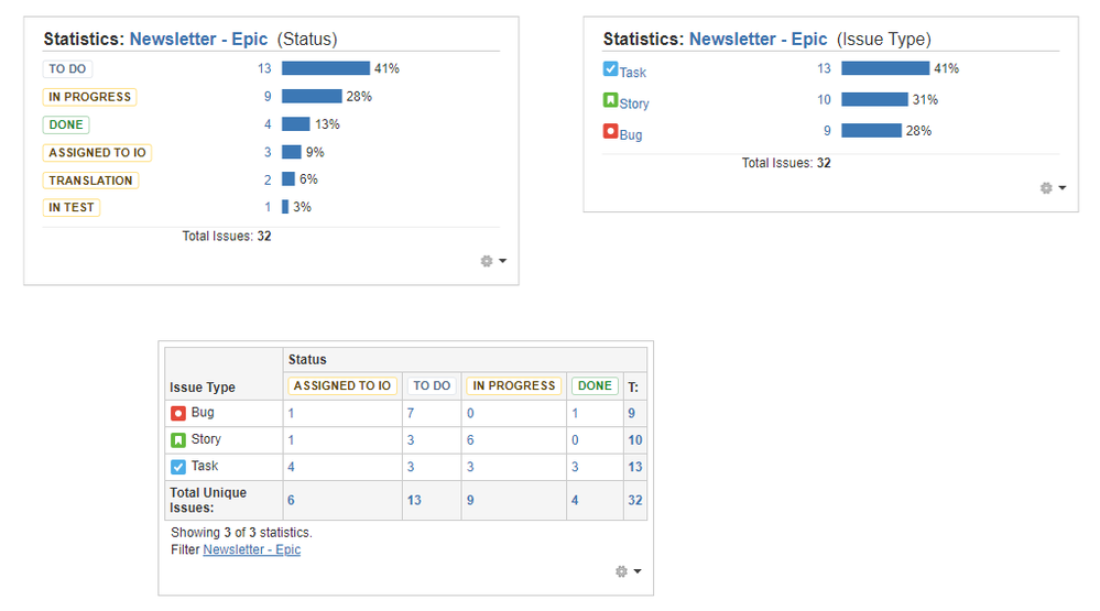

I have found a solution for the Issue statistics, when I select
  • Sort by = Total --> they all show
  • Sort by = natural --> only 4 show
But the above is no solution for the Two Dimensional Filter. The statistics below are all based on the same project, but give a different result.
And the same when I switch X and Y:

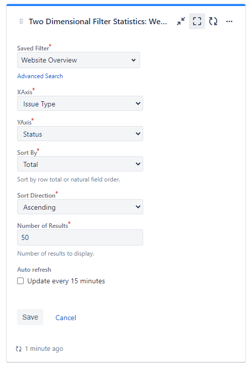

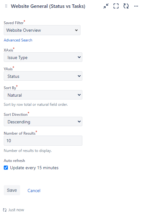

This looks really odd to me, but I want to ask you to do two more things if you have time.
In the config of the 2d gadget, change the "number of results" to 50 (I think that's the maximum.  Similarly for the other gadgets you're trying (if they have the option)
A longer one, and only to help us here to debug it - choose a filter that causes the problem, but returns only a short data set.  Screenshot the dashboard gadget showing the problem for us (we'll assume the config is the same), and then go run the filter, and show us the results from the issue navigator (text in a table is fine if you don't want to screenshot).  We only need three columns - issue key, issue type and status.

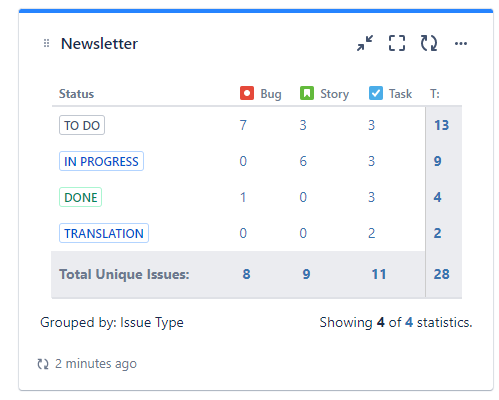

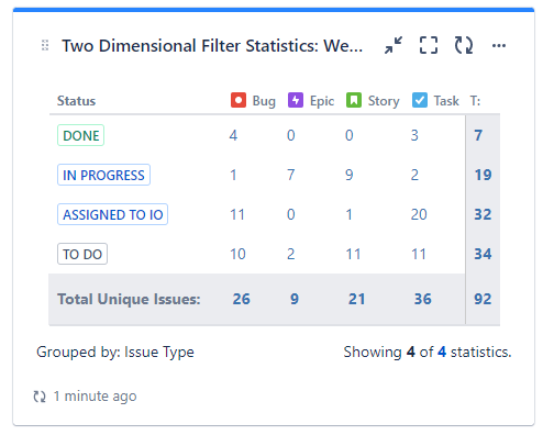

Evelien.Roze
January 25, 2023
I have done the changes as in your first request, but no change here:

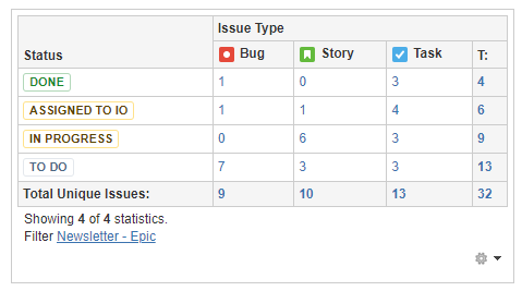

January 25, 2023
Fantastic, thank you!
(Well, not fantastic, because it doesn't show us the problem)
One last step - was that last table generated by clicking "Newsletter - Epic" under the charts?  What is the filter defined behind "Newsletter - Epic"?
I doubt we will see anything wrong, but this is all stuff Atlassian are likely to ask if we can get them on to it.
Jack Brickey
January 25, 2023
Or is the filter Website Overview? Are we testing with different filters here?
Evelien.Roze
January 27, 2023
The latest ones I have uploaded are all based on the filter 'Website Overview', but I have the issue with all the filters I have set-up in this project.
Do you want the screenshots for filter Newsletter-Epic?
