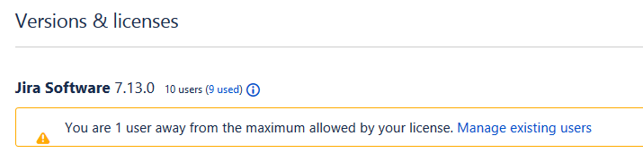

We have 14 Users on our Confluence/Jira instance (starter license). (4 are disabled)
All the Users have access to Jira and Confluence.
We want to deactivate one of our two administrators because we don’t need him anymore and activate one of the diasabled users.
When I deactivate the Admin in Jira and synch it to Confluence.
Confluence says that there are still 10 Users active although Jira has only 9 users active.

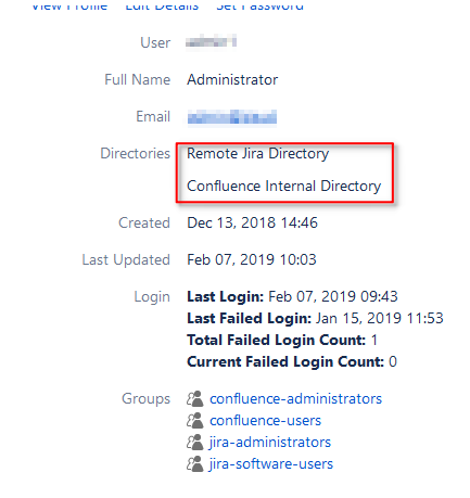

This might mean that Confluence has a user created within the Confluence Directory, outside of the Jira user directory.
Can you please check your users and see if any users have a Directory of "Confluence Internal Directory"?
Here is an example screenshot:

I just double checked and see the user I want to deactivate is in both directories.
That means I must deactivate him in Jira and then in Confluence as well?

Since that Administrator user most likely existed within Confluence prior to the Jira user directory being connected, the user must be disabled on both sides if you wish to reclaim that users license in Confluence and Jira. The reason for this is that the user is from the internal directory and not a user created from the Jira user directory sync.
Disabling the user you have shown above, and then refresh your license count should put you at 9 users. (Ensure you have another admin account within Confluence before you do this).

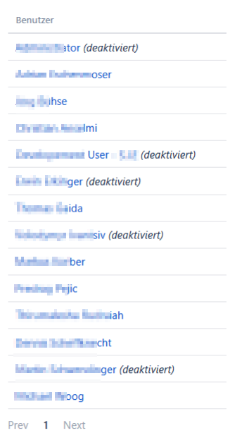

I disabled the user in Jira then go to confluence and synch the users then I changed to the User directory and had the following List.
As you can see there are 5 Users Deactivated and 9 activated.
After that I go to the license Tab and click on refresh.
As you can see nothing happens.

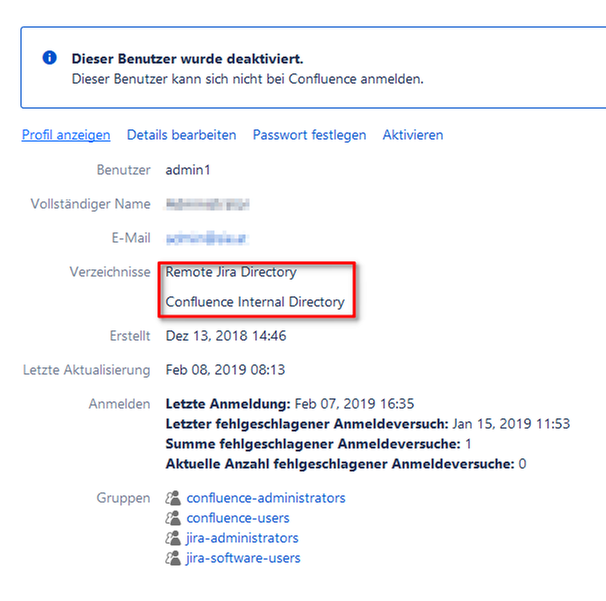

Here is the Windows of the Administrator I deactivated. Everything seems fine.

I understand how this works, but I don’t understand why we have 10 used licenses but only 9 users activated.
As you can see on my second reply on Thursday (Picture of user list) that I have only 9 users activated but still have 10 that counting towards my license.

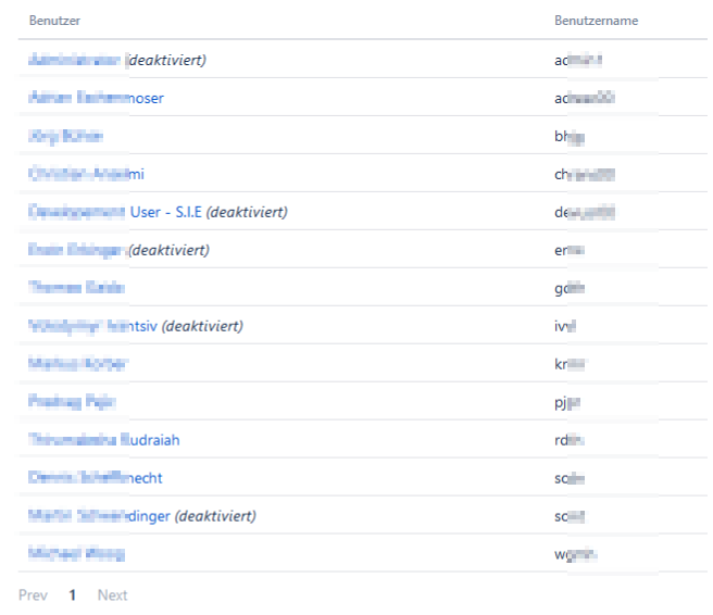

February 13, 2019
Hello Stephan,
as you can see in Jira and Confluence are 5 Users disabled an 9 active.
Confluence                                                                    Jira
And here the screenshots of the license view
