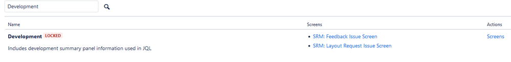

In a company-managed work-management jira, I have created a custom issue type (type: task), with an associated workflow, screen, etc... and field configuration. In this field configuration I looked up the "Development" (locked field), which I believe is the same field in standard software Jira to see branches from Bitbucket. Unfortunately, when adding this field to my screen I still cannot see it. I also have other custom fields which work fine.

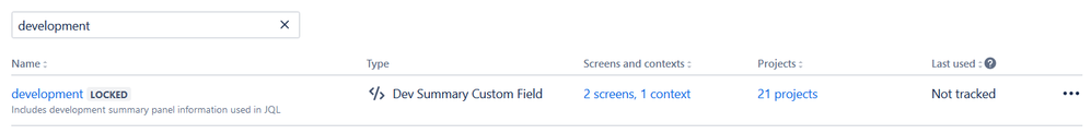

Looking at your screenshot, I think there are 2 fields named development, one with a capital D and one without.
Are you sure have selected the correct field?

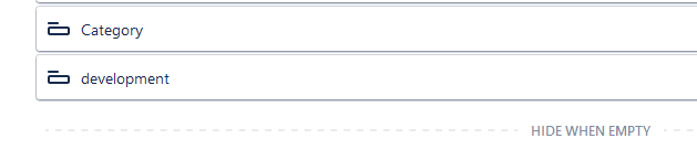

Hi @Marc - Devoteam,

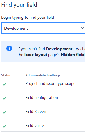

I find it weird as well, but there are no other fields available. As you can see in the screenshots, the field is present, just hidden. However, I have no idea where it was set hidden (since it's a locked field), and the field should be displayed even if empty.

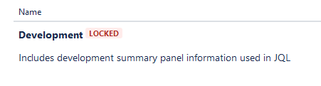

Hi @Marc - Devoteam
Thanks for the help.
I have looked again, but I cannot find where the field might be hidden. I'm sending you again the field from the project field configuration (and this issue type) uncropped:

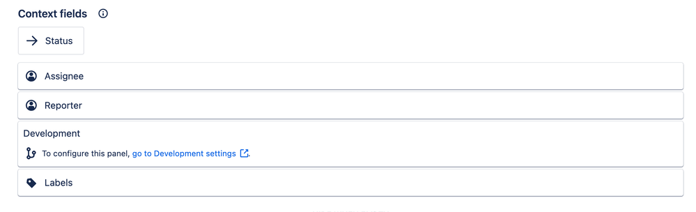

Hi @[deleted]
I check my system on Cloud and the field Development (Locked) is not addable to a screen.
This is part of the Development panel.
So the field development on you screen is not related to the development (locked), but a created custom field.

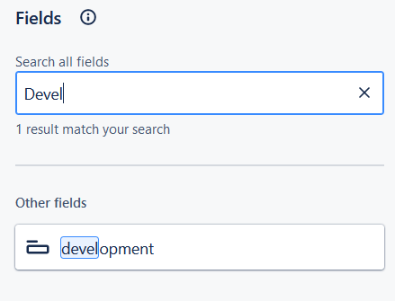

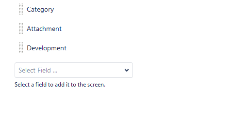

Deleted user December 1, 2023
Hi @Marc - Devoteam
Okay I found the field in the "Custom Fields", but it is still native from Jira:
For some reason, in the project field configuration, this same field goes from "development to "Development", I cannot find another. The field is there in the field configuration, but if I remove it from the screens (from the field configuration page), such that it is no more in a screen, and then I try to look it up from the screen, I cannot find, although it belongs to the field configuration...

I would contact Atlassian on this, to have them check your backed.
There might be an issue on your instance.
I have multiple Cloud instance and al only have one Development field that can't be chosen as an option on a screen, or have context set.
Might it be that you migrated from Server to Cloud and it was a custom field then and now on Cloud it has been seen as the default development field and set to locked?
