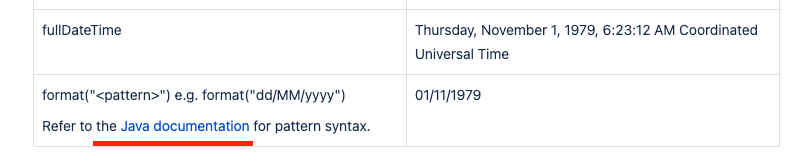

To extract the just the hour from the results on convertToTimeZone you would need to use the format command with a valid input as described here:
I think what you will need to use is one of these
now.convertToTimeZone("America/New_York").format("h") - to get the hour as 1-12
now.convertToTimeZone("America/New_York").format("k") - to get the hour as 1-24
