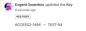

Evgenii
June 18, 2025
Hi, @wvacchiani
No need to use additional methods. You can use basic "Get Issue" method.
Url will look like https://your-company.atlassian.net/rest/api/3/issue/TEST-94?expand=changelog
You will see there such array:
"items": [
"field": "issuetype",
"fieldtype": "jira",
"fieldId": "issuetype",
"from": "10138",
"fromString": "Bug",
"to": "10012",
"toString": "Task"
"field": "project",
"fieldId": "project",
"from": "10065",
"fromString": "ACCESS 2.0",
"to": "10088",
"toString": "TEST"
"field": "Key",
"from": null,
"fromString": "ACCESS2-1494",
"to": null,
"toString": "TEST-94"
3 votes

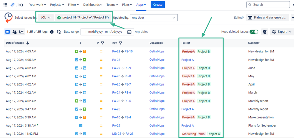

Serhii Kibitkin_SAASJet_
June 15, 2025
Hi @wvacchiani
If you are open to using third-party apps, Issue History for Jira, developed by my team, can help with this case.
You can filter several projects with JQL and explore ticket changes in the project field.
