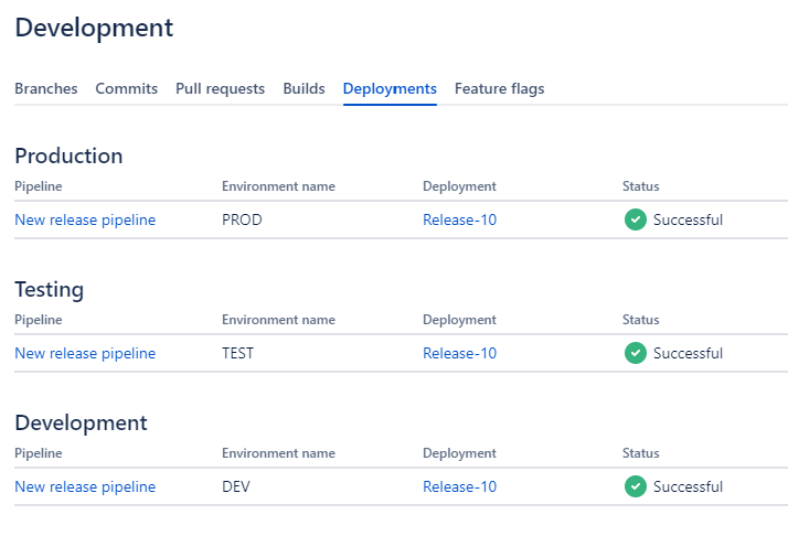

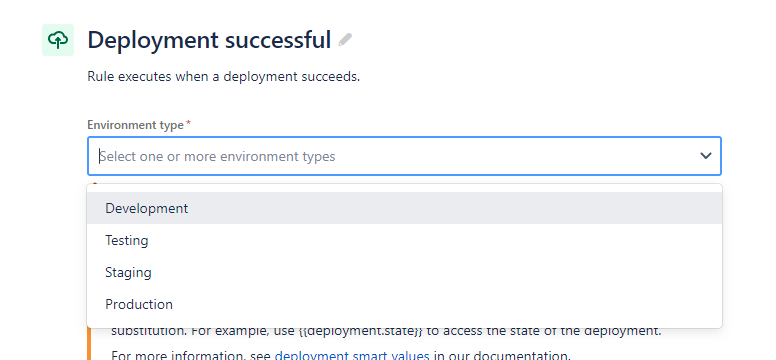

I'm trying to help a team (that have a release pipeline interacting with Jira currently) with some automation to transition the relevant story/s to Done upon completion of a successful deployment.
But we are struggling to work out what the Environment Types represent in the " Deployment Successful" trigger option.
We have data coming through showing the "environment name" (which are the Stages in their Azure DevOps Release Pipeline) but how do we trigger the automation via these "environment types" in the trigger? Env name.png

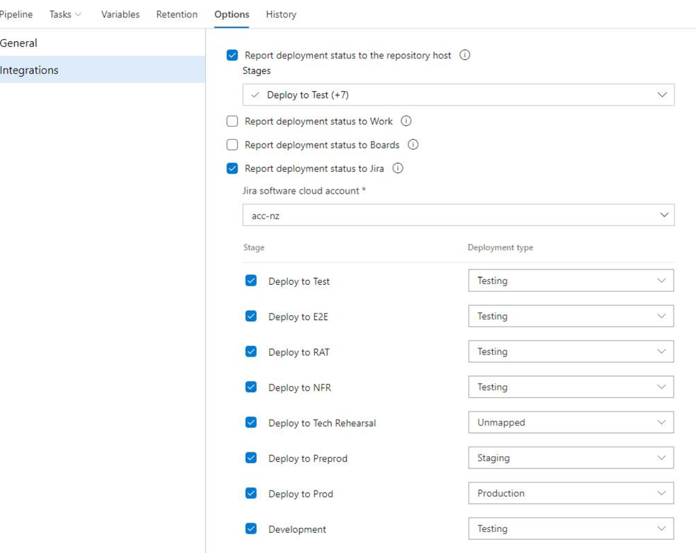

Thanks @tomas but that much I knew. What I was after was how that is mapped from Azure DevOps.
The answer; via "Deployment type"

tomas
February 25, 2021
So this environment is used to distinguish for which environment we want to trigger the automation rule.
So when we select `production` the rule will only trigger the rule when a commit is deployed to production.
