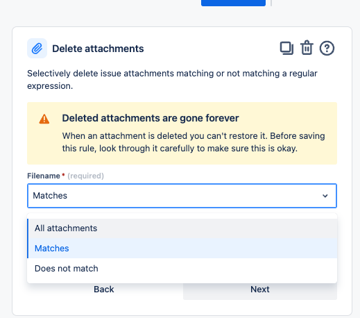

With Automation rules you can select issues based on the Resolved date (if that is the same in your environment to when you would consider the issue "closed"). You can then execute an action in the rule to Delete Attachments for each issue selected.
You can delete all attachments or use a "matches" or "does not match" condition with a regex to specify the attachments to be deleted.
You could run such a rule on a schedule to find all the issue that have "newly" entered the range of having been closed for 2 years.
What is the current count of issues that have been closed for 2 years or longer for which the attachments need to be deleted? There are limits to how many issues can be processed in the run of a rule, so dealing with a backlog may require running a rule multiple times.
Once again I have to stress that if you use the above action the attachments are permanently deleted. There is no "undo" option if you make a mistake, and there attachments are not moved to a "trash" bin from which they can be recovered. The are irrevocably gone. So, if you created an automation rule such as this I would very strongly caution you to do testing of the rule where you don't actually include the Delete Attachments action. Instead use the Log Action to write to the rule execution audit log what issues would be affected, and maybe even write information about the attachments that would be deleted.
