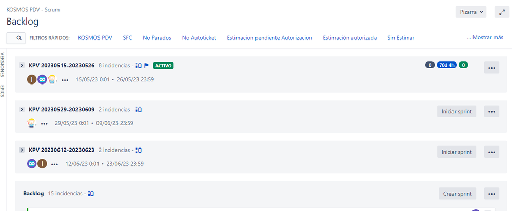

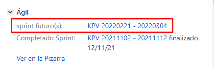

We have a problem with some sprints in our environment that we do not fully understand, in some issues there is a section called "future sprint" however when we access the dashboard we do not see any sprint with that name, is there any way to remove these sprints?

Hi @Pedro J. Acosta
Are you sure your are looking into the right board ? If the Sprint field is displayed in the create or edit screen, someone may have set the value to the wrong Sprint, a sprint that is not expected as the Sprint field display all sprint on the instance.

Hello @Florian Bonniec
I'm not entirely sure, but I think so since the "Sprint" field does not exist on any screen except the detail of the issue.

Florian Bonniec
May 17, 2023
If this Sprint has been assigned to the issue but it's not related to the board, it has probably been set through the Sprint field directly or the issue is present in another Sprint board.
If you want to remove it, you can go to the board the Sprint is managed in and remove your issue.
In order to do that, you can run a JQL query Sprint = "Sprint Name", JIRA should replace the Sprint name by the sprint ID. From this ID you should be able to find the related board using the rest api.
https://docs.atlassian.com/jira-software/REST/9.8.0/#agile/1.0/sprint-getSprint
You should be able to reach the baord by replacing th id in the board url you are using by the one returned by the rest call.

Pedro J. Acosta
May 18, 2023
Hello @Florian Bonniec ,
We already tried to do that, but when we access the dashboard we don't see the sprint anywhere and we don't know how to locate it.
